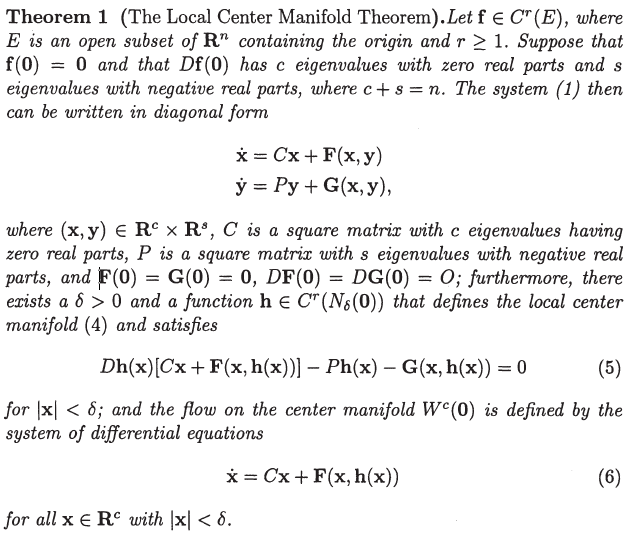

which obviously has the eigenvalue ##\lambda = 0##, with the eigenvector ##\mathbf{v}=\begin{bmatrix}1 & 0 \end{bmatrix}^T##. In the book (Differential Equations and Dynamical Systems 7. edition, by Perko) we are using in my introductory course on dynamical systems, we have the following theorem
We are advised to use polynomial approximations to find ##h(x)##. However, since s = 0 (both eigenvalues are 0 exactly) I don't know how to utilize the theorem. With ##c = n## it would seem as though ##P## and ##G## has a dimensionality of 0, and ##C## is a 2 by 2 matrix with just zeros in it, effectively making ##\mathbf {F}=D\mathbf {f}##. Another big problem is that this means ##h## is 2D and not 1D as would seem intuitive (since the geometric multiplicty of ##\lambda=0## is 1), and that obviously does not make sense, as the system itself is 2D. Can someone perhaps see where I'm going wrong here? I suspect that the theorem simply doesn't work for this case, and that it is missing the condition that ##s \geq 1##, but its just a hunch.

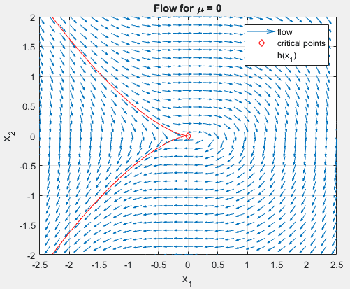

It should be said that some guess work has lead me to a function
\begin{align}
\dot{x}_2 = h(x_1) = \sqrt{-\frac{1}{3}x_1^3 + c}
\end{align}
where ##c = 0## so as to make it fit with the critical point. This seems to visually to do exactly what I want it to
Not sure this helps, but I thought I'd add it.

Applying the theorem as stated would lead you to conclude that the center manifold is [itex]\mathbb{R}^2[/itex], and that the dynamics on the centre manifold are governed by a system which is the system you started with, [tex] \dot{\mathbf{x}} = C\mathbf{x} + \mathbf{F}(\mathbf{x}) = \begin{pmatrix} 0 & 1 \\ 0 & 0 \end{pmatrix}\mathbf{x} + \begin{pmatrix} 0 \\ -\frac12 x_1^2 \end{pmatrix}.[/tex] So it does work; it just doesn't help you.
