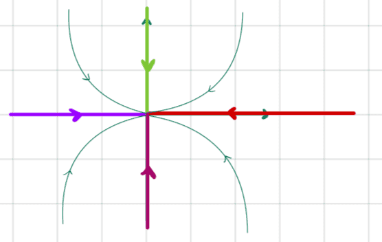

At ##(0,0)## we have
$$\begin{bmatrix}x'\\ y'\end{bmatrix}=\begin{bmatrix}-1&0\\0&-2\end{bmatrix}\begin{bmatrix}x\\ y\end{bmatrix}$$
The eigenvalues are ##-1## and ##-2## and associated eigenvectors are ##\hat{i}## and ##\hat{j}##.
The general solution is
$$\vec{x}=c_1e^{-t}\hat{i}+c_2e^{-2t}\hat{j}$$
and here is a phase portrait

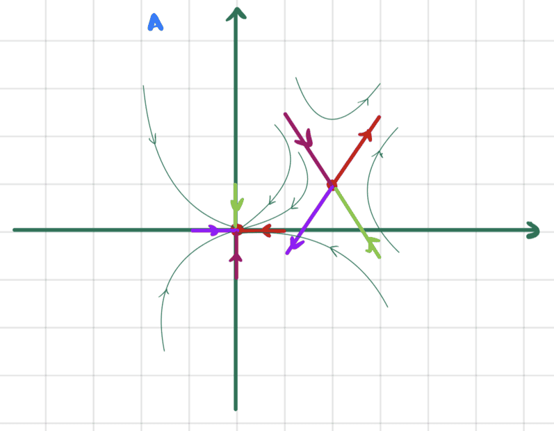

At ##(2,1)## we have
$$\begin{bmatrix}x'\\ y'\end{bmatrix}=\begin{bmatrix}0&2\\1&0\end{bmatrix}\begin{bmatrix}x-2\\ y-1\end{bmatrix}$$
Eigenvalues are ##\pm\sqrt{2}## and associated eigenvectors are ##\langle 1,\pm\sqrt{2}\rangle##.
$$\begin{bmatrix}x-2\\ y-1\end{bmatrix}=c_1e^{\sqrt{2}t}\begin{bmatrix}1\\\sqrt{2}\end{bmatrix}+c_2e^{-\sqrt{2}t}\begin{bmatrix} 1\\ -\sqrt{2}\end{bmatrix}$$
Here is a phase portrait
My question is how to draw the phase portrait of the original system by combining the two phase portraits I drew.
Note that the phase portraits represent linearized behavior of the system about the critical points. As far as I know, though I drew the phase portraits showing how linear solutions behave for all $t$, we are only using these linear solutions to get an idea for the behavior near the critical points.

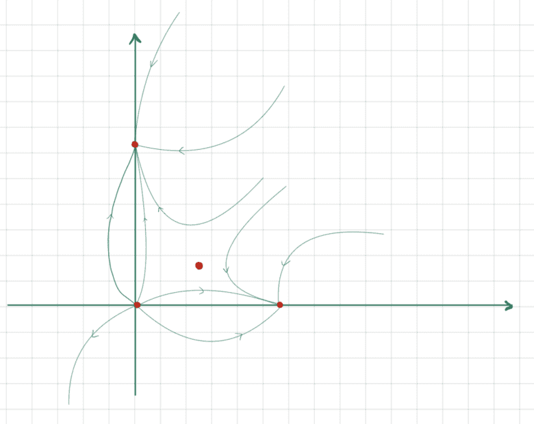

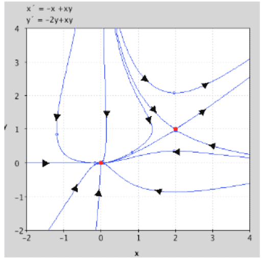

There is an accompanying example in some notes I am following and they draw the phase portrait as
It is not clear to me how some of these solutions were obtained.
For example, the one in the bottom right.
So far I have the following
I guess my doubt is about what happens, for example, around region A above.
But I realize now that the behavior far away from the critical points is not important, or at least not confidently characterizable by these linear approximations, which are maybe accurate only near the critical points.
I am asking about general techniques and tips on how to do this.

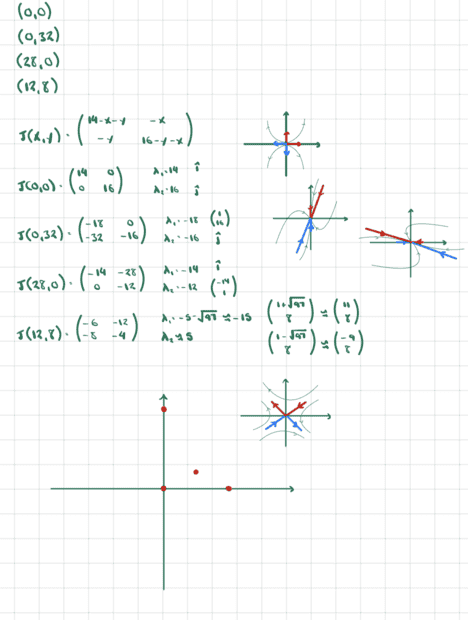

Here is another, more complicated example
$$x'=14x-\frac{x^2}{2}-xy$$
$$y'=16y-\frac{y^2}{2}-xy$$
Since it will take too long to write out the calculations, here they are by hand

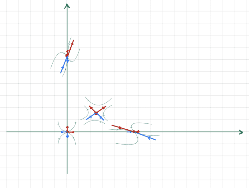

Above, initially I show four critical points and the Jacobian matrix for linearization.
Then I evaluate the Jacobian at each of the critical points and compute eigenvalues, eigenvectors and draw a small rough phase portrait (note that I am centering at the origin but actually the solutions should be at the critical points).
The final question is how to combine all four phase portraits into a phase portrait of the initial system.
Is this more like an art?
I think one important thing is to consider whether a critical point is stable or not.
