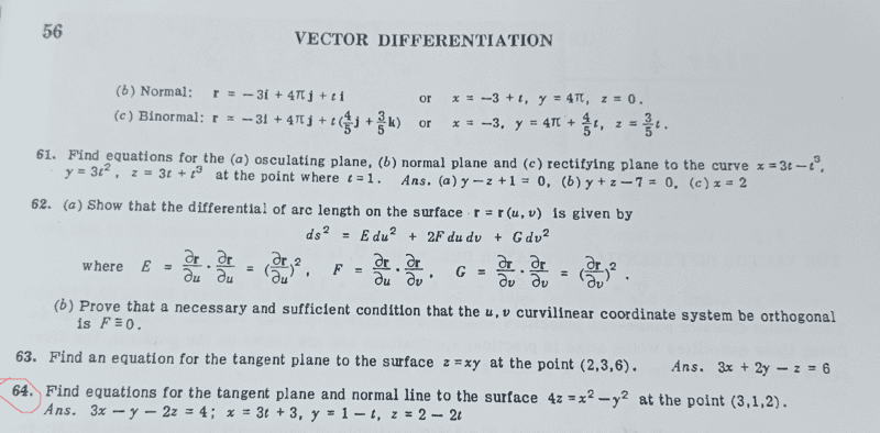

See attached ##Q.64## highlighted in red.
vector differentiation
In my line i have,
##\dfrac{∂r}{du} = \vec{i} +\dfrac{1}{2}u \vec{k} = \vec{i} +1.5 \vec{k}##
##\dfrac{∂r}{dv} = \vec{j} -\dfrac{1}{2}v \vec{k} = \vec{j} -0.5\vec{k}##
The normal to plane is given by,
##\dfrac{∂r}{du}× \dfrac{∂r}{dv} = -\dfrac{3}{2} \vec{ i} + \dfrac{1}{2}\vec{j}+\vec{k}##
The equation of the tangent to the plane is given by,
##-\dfrac{3}{2} (x-3)+ \dfrac{1}{2}(y-1)+1(z-2)=0##
##-3(x-3)+(y-1)+2(z-2)=0##
##-3x+9+y-1+2z-4=0##
##-3x+y+2z+4=0##
##3x-y-2z=4##
looks good... just need to confirm/check on the Normal line equation. Insight is welcome.
Cheers.
Correction: The equation of the tangent plane; that is the plane that is tangent to the surface at the given point.
Did you calculate the equation of the normal line? If so you didn't include it in your work. You have a vector that has the same direction as the normal line, and a point on this line, so it's quick work to come up with the equation of that line.
