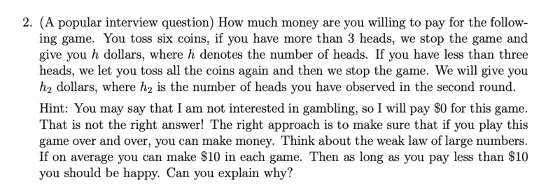

summary: you toss six coins. if you have 3 heads, you don't get any money. if you have 4 or more heads, you get the number of heads amount of dollars. if you have 2 or less heads, you toss six coins again and get the number of heads amount of dollars.
the number of ways to get 0 head ##\frac{6!}{(6)!1!}=1##
the number of ways to get 1 head ##\frac{6!}{(6-1)!1!}=6##
the number of ways to get 2 heads ##\frac{6!}{(6-2)!2!}=15##
the number of ways to get 3 heads ##\frac{6!}{(6-3)!3!}=20##
the number of ways to get 4 heads ##\frac{6!}{(6-4)!4!}=15##
the number of ways to get 5 heads ##\frac{6!}{(6-2)!2!}=6##
the number of ways to get 6 heads ##\frac{6!}{(6-2)!2!}=1##
$$P(X<3)=\frac{22}{2^6}$$
$$P(X=3)=\frac{20}{2^6}$$
$$P(X>3)=\frac{22}{2^6}$$
$$E(X<3)=E(X)=3$$
$$E(X=3)=0$$
$$E(X>3)=\frac{15}{21}\cdot 4+\frac{6}{21}\cdot 5+\frac{1}{21}\cdot 6=\frac{32}{7}$$
the expected value of the game is
$$P(X<3)E(X<3)+P(X=3)E(X=3)+P(X>3)E(X>3)$$
$$=\frac{22}{2^6}\cdot 3 +\frac{20}{2^6}\cdot 0 + \frac{22}{2^6} \frac{32}{7}=\frac{583}{224}\approx 2.6$$
If I was given this question, the first thing I would say is "what happens if you get exactly 3 heads?" The question doesn't say. You seem to be assuming this means you get nothing, but is that correct? I'd say the game is not fully specified.
PS in calculating E(X>3), the probabilities should be 15/22 etc., not 15/21 etc.

oops yes rhat was a mistake. It turns out my professor changed the prompt to "equal to greater than 3 heads".$$P(X\geq 3)=\frac{42}{2^6}$$
$$E(X\geq 3)=\frac{20}{22}\cdot 3+\frac{15}{22}\cdot 4+\frac{6}{22}\cdot 5+\frac{1}{22}\cdot 6=\frac{78}{11}$$
$$\frac{22}{2^6}\cdot 3 +\frac{42}{2^6}\frac{78}{11}= \frac{2001}{352}\approx5.68$$

Can you write a computer simulation to check that?
In any case, that number must be too high. It means you're getting 5-6 heads almost every time.

ahhhhh! I forgot to divide everything in ##E(X\geq 3)## by 42 instead of 22 so ##E(x\geq 3)## is smaller.
$$E(X\geq 3)=\frac{20}{42}\cdot 3+\frac{15}{42}\cdot 4+\frac{6}{42}\cdot 5+\frac{1}{42}\cdot 6=\frac{26}{7}$$
$$\frac{22}{2^6}\cdot 3 +\frac{42}{2^6}\frac{26}{7}\approx 3.46$$

I think it's easier to observe that if you get fewer than 3 heads the first time, you play a game whose expected outcome is $3 and if you get at least 3 heads the first time you get an amount equal to the number of heads. So the expectation should be [tex] \frac{22}{2^6} \cdot 3 + \frac{1}{2^6}\left( 20 \cdot 3 + 15\cdot 4 + 6 \cdot 5 + 6 \right)[/tex] which is your result.
However, rather than do that calculation I would say that the expected number of heads from flipping six coins is 3 and this game has a strictly higher expectation. So at $3 I know my expected outcome is positive.
