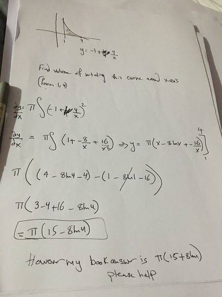

I have the attached problem ,and Show my answer and solution,
My answer is 3.14*(15 -8ln4)
While book answer 3.14(15+8ln)
Can anyone point to the mistake I made?
Your work also looks good to me.
The one thing I noticed is the answer from the book would be right if you take the negative away from the 1.
I'm guessing the book has a typo.

If this is actually the book's answer, it makes no sense without something following ln.

If you think that the book's answer ##\pi (15+8 \ln(4))## is close to the correct answer you are very much mistaken. The correct answer is yours, except that the approximation ##\pi = 3.14## is way too crude---just leave it as symbolic ##\pi## until it comes time to evaluate the final answer numerically. Look at the following:
[tex]\begin{array}{rccc}<br /> \pi (15 - 8 \ln\,4 )& \doteq & 12.28251236 & \doteq & 12.3 \\<br /> \pi (15 + 8 \ln\,4 ) & \doteq & 81.96526726 & \doteq & 82.0 \\<br /> \pi 15 & \doteq & 47.12388981 & \doteq & 47.1<br /> \end{array}<br /> [/tex]

You are right his answer is not logical,
