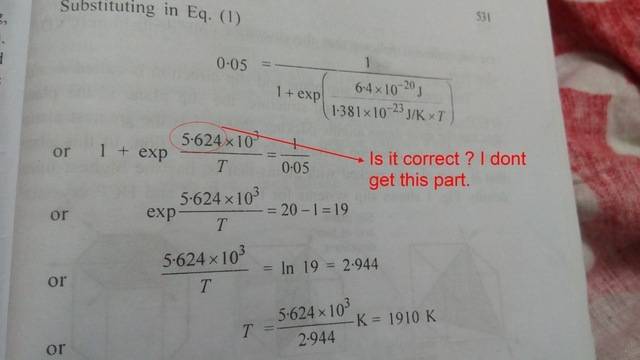

Here is a simplification of a problem given in my book. I don't get the simplification part.
Could you please help at this ? It seems book has done the calculation wrongly.
6.4/1.381 = 4.634. There is no obvious typo that would lead to 5.624 and the Boltzmann constant is correct. I don't understand the calculation done in the book.
here is the problem:
6.4 1020 is the 0.4 eV expressed in Joules.
The 5.624 would correspond to 0.485 eV, 7.77E-20 J, or a wrong Boltzmann constant of 1.138 instead of 1.381.
Maybe the last one is the cause of the mistake, it can be explained by swapping the digits.
