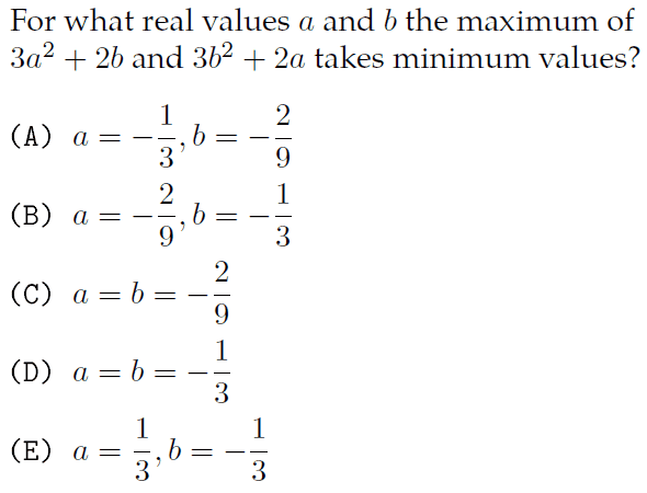

I don't think I understand what the question is asking. Find ##a## and ##b## so that the maximum takes the minimum values?
If ##a## and ##b## are real numbers, the maximum values of ##3a^2+2b## and ##3b^2+2a## are infinity. How can infinity take minimum value?
I have calculated the values of ##3a^2+2b## and ##3b^2+2a## for each given option:
Option (A): ##3a^2+2b=-\frac{1}{9}## and ##3b^2+2a=-\frac{14}{27}##
Option (B): ##3a^2+2b=-\frac{14}{27}## and ##3b^2+2a=-\frac{1}{9}##
Option (C): ##3a^2+2b=-\frac{8}{27}## and ##3b^2+2a=-\frac{8}{27}##
Option (D): ##3a^2+2b=-\frac{1}{3}## and ##3b^2+2a=-\frac{1}{3}##
Option (E): ##3a^2+2b=-\frac{1}{3}## and ##3b^2+2a=1##
What do this values tell me and how should I actually interpret the question?
Thanks
The question is, which ##a## and ##b## minimize ##max(3a^2+2b,3b^2+2a)##.

Note that sapping [itex]a[/itex] and [itex]b[/itex] swaps [itex]3a^2 + 2b[/itex] and [itex]3b^2 + 2a[/itex], leaving the maximum invariant. Note also that [itex]3a^2 + 2b[/itex] is strictly increasing in the direction of increasing [itex]b[/itex], and [itex]3b^2 + 2a[/itex] is strictly increasing in the direction of increasing [itex]a[/itex].
These observations suggest that [itex]\min_{(a,b)} \max \{3a^2 + 2b, 3b^2 + 2a\}[/itex] lies on the line [itex]a = b[/itex] - and only one of the given options satisfies this.

Awesome! To add, if ##a=b##, then
$$3a^2+2b=3b^2+2a=3a^2+2a.$$
And the global minimum of ##3a^2 + 2a## for all ##a\in \mathbb{R}## is $$3\cdot \frac{1}{(-3)^2}+3\cdot \frac{1}{-3}=-\frac{1}{3}.$$ This indeed seems to be the minimum value of [itex]\max \{3a^2 + 2b, 3b^2 + 2a\}[/itex] considering all ##a,b\in \mathbb{R}##.
However, the implied conclusion is not perfectly right because the condition '##a=b##' doesn't guarantee the minimum quantity of [itex]\max \{3a^2 + 2b, 3b^2 + 2a\}[/itex]. It depends on the given choices of ##a## and ##b##.

To minimize ##\max \{3a^2 + 2b, 3b^2 + 2a\}## is the same as to minimize ##\max \{(3a^2 + 2b)-(3b^2 + 2a), 0\}##.
The latter is minimized when ##0=(3a^2 + 2b)-(3b^2 + 2a)=3(a^2-b^2) - 2(a-b)=(a-b)(3(a+b)-2)##.
This happens when either ##a-b=0## or ##3(a+b)-2=0##.
So, the minimum happens when either ##3a^2 + 2a## or ##3a^2 + 2(2/3-a)## is minimized.
The mins of the last two expression are easy to find and then we take the smaller of the two.

I understand the 1st paragraph but sorry I don't understand the 2nd one. How can we know the answer will lie on the line [itex]a = b[/itex]? How can we draw this conclusion from the fact [itex]3a^2 + 2b[/itex] is strictly increasing in the direction of increasing [itex]b[/itex], and [itex]3b^2 + 2a[/itex] is strictly increasing in the direction of increasing [itex]a[/itex]?

I think option (C) and (D) are still possible?
Thanks
Here's an alternative approach. Note that we must have ##a, b < 0##. As both expressions are less in this case than for the equivalent positive numbers. We can take ##c = -a, d = -b##, with ##c, d > 0## and minimise the maximum of: ##3c^2 - 2d## and ##3d^2 - 2c##. Now, for ##c, d > 0## we have:
$$3c^2 -2d \ge 3d^2 - 2c \ \iff \ c \ge d$$You can check that out. Using the symmetry, that lets us minimise ##3c^2 - 2d## for ##c \ge d > 0##. This is clearly minimised when ##c = d##. Finally, therefore, we minimise ##3c^2 - 2c## for ##c > 0##. Then, the solution to the original problem is ##a = b = -c##.

Keeping ##a## fixed, ##3a^2 + 2b## is strictly increasing in the direction of increasing ##b##, and keeping ##b## fixed, ##3b^2 + 2a## is strictly increasing in the direction of increasing ##a##. Therefore, one of ##3a^2 + 2b## or ##3b^2 + 2a## is greater than the lesser of ##3a^2 + 2a## or ##3b^2 + 2b##.
It follows that if there is some number, ##R##, such that ##3r^2+2r## is a minimum at ##r=R##, then it seems you have a solution. ##a=b=R## .
You shouldn't need to use Calculus if you understand quadratic functions .

To be honest, what I'm struggling to understand is that if one's given several choices for ##(a,b)##, including one choice such that ##a=b##, the value of ## \max \{3a^2 + 2b, 3b^2 + 2a\}## with ##a=b## is not necessarily be the minimum over all possible choices of ##(a,b)##.

Exactly this.
What is the minimum of ## \left\{ \frac 1 3, \frac 8 {27} \right\} ##?

This is true, but it is not necessary to observe this to answer the question, and nor is it sufficient because
is not correct: both (C) and (D) satisfy ## a = b ##.
