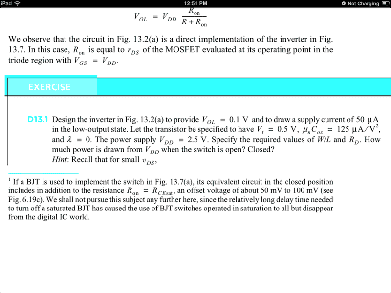

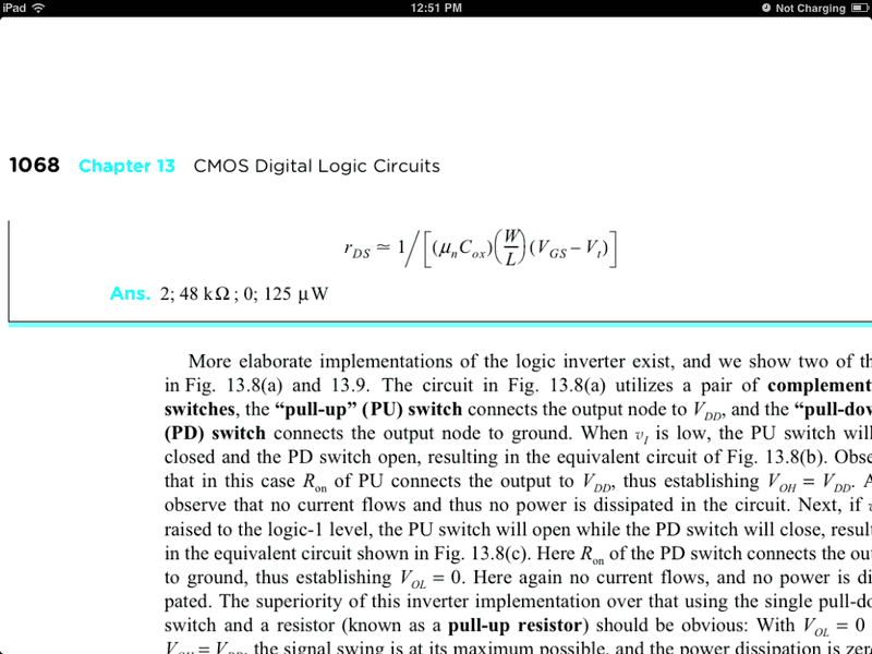

How to find W/L??
The exercise already tells me that the value of W/L is 2. However, I can't seem to understand where that result came from. I'd like to know how I can get to that conclusion.
Here is the exercise with the graph of the inverter:
Inverter image:
http://i1226.photobucket.com/albums/ee410/jean28x/image2_zps9e7f8724.png
Exercise, part 1:
http://i1226.photobucket.com/albums/ee410/jean28x/image_zps136b69f7.png
Exercise, part 2:
http://i1226.photobucket.com/albums/ee410/jean28x/image_1_zps32b9a8ee.png

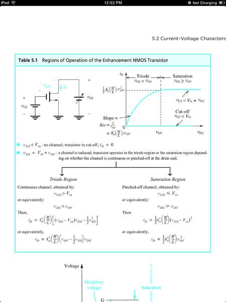

Here is a picture of relevant formulas of MOSFETS:
http://i1226.photobucket.com/albums/ee410/jean28x/image_2_zpse3d8245e.png
There is also the formula in the hint that is given in the exercise:
So, using the formula given in the hint, I substitute the values (I already know the 48 KΩ part):
48k = 1/((125μ)(W/L)(2.5 - 0.5))
Solving for W/L, I get:
12 = 1 / (W/L)
W/L = 1 / 12 = 0.08333
However, the answer says that W/L is supposed to be 2. What am I doing wrong here?
Thanks a lot.P.S.
It might be worth noting that, since this is an exercise working with CMOS circuits, then the relevant state that it should be analyzed in is in Triode and Cutoff modes.

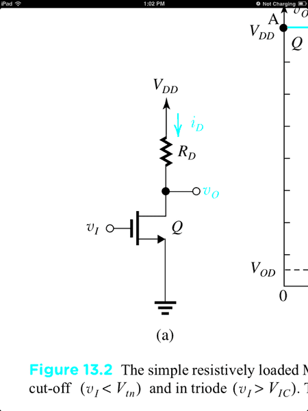

  • Circuit schematic (a) of a simple resistively loaded NMOS inverter: VDD at top, resistor R_D with current i_D, output v_O at the drain node, input v_I at the gate of transistor Q, source grounded.

  • Screenshot of a textbook page showing the equation V_OL = V_DD × R_on/(R + R_on), a sentence about the inverter in Fig. 13.2(a), and Exercise D13.1 on designing an inverter with V_OL = 0.1 V, supply current 50 µA, V_DD = 2.5 V, and a footnote on BJT switches.

  • Screenshot of a textbook page from Chapter 13, CMOS Digital Logic Circuits, page 1068, showing the equation r_DS ≈ 1 / [(μn Cox)(W/L)(VGS − Vt)] and an answer line with printed text about a pull-up switch and pull-down switch in a CMOS inverter.
