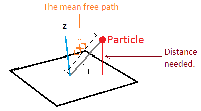

"Show that particles hitting a plane boundary have traveled a distance 2λ/3 perpendicular to the plane since their last collision, on average."
(Root mean path squared) <x> = 2^(.5)λ
λ = ( 2^(.5) * n * sigma )^(-1)
ANSWER:
[/B]
I already knew I needed <x cos(theta)>.
The book tells me that I can split x and cos(theta) apart by this rule:
My issue is that I do not understand how to calculate the average angle. I know the boundaries are 0 < theta < pi/2.
I would expect the average angle to be pi/4.
(NOTE: I measured the angle from the plane and should have shown measurement from the z axis down to satisfy the cos(theta).
So I figured that if I can just determine the average angle, I could plug it into <x> * cos(theta) and I would be done. However, that does not seem to work.
But you don't want the average angle - you want the average of cos(θ).
Despite the diagram, I believe θ here is the angle to the normal. Consider a hemisphere centred on the impact point on the wall. Particles come equally likely from each small area element on the hemisphere. For the region between θ and θ+dθ from the normal, what area is that? What integral can you write down for the average of cos(θ)?

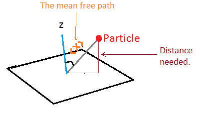

Kevin Willis said:
This should be the average of cos(θ).
Not sure we're in agreement over which angle is theta. Since you are interested in perpendicular distance and are taking that as cos(theta), I believe theta is the angle to the normal. But in your diagram you mark an angle to the plane, and the above calculation also seems to be taking it as the angle to the plane.
I do mean angle from the normal. In the OP I wrote "(NOTE: I measured the angle from the plane and should have shown measurement from the z axis down to satisfy the cos(theta)." directly under the diagram.
So, cos(theta) here is measuring perpendicular distance. Parallel would be sin(theta). I have submitted the correction below to clear any misunderstandings.
So, cos(theta) here is measuring perpendicular distance. Parallel would be sin(theta). I have submitted the correction below to clear any misunderstandings.View attachment 79369
Ok, then I disagree with your integral for the average value of cos theta. How do you arrive at that?
