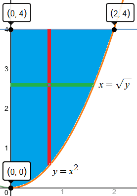

Consider the following diagram of the region $R$ from the example I posted:
Now, if we consider this a region of Type I, then the outer integral will be in terms of $x$, which we see ranges from $0\le x\le 2$, and the inner integral will be in terms of $y$, which we see ranges from $x^2\le y\le4$...the vertical red strip.
If we consider this a region of Type II, then the outer integral will be in terms of $y$, which we see ranges from $0\le y\le 4$, and the inner integral will be in terms of $x$, which we see ranges from $0\le x\le\sqrt{y}$...the horizontal green strip.
An excellent reply.
