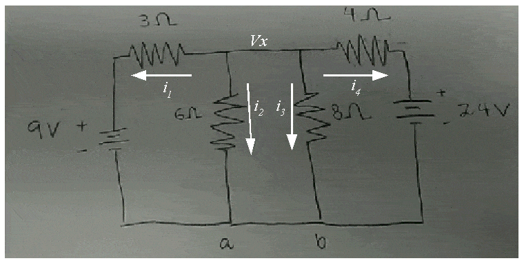

3. Attempt
I believe there are 4 currents, as shown above. i1 and i2 are coming from the 9 volt battery in a clockwise direction and i3 and i4 are from the 24v battery in a anti clockwise direction. I just apply kirchkoffs law for each current with the resistor in its path way.
Ex. For i1 the equation would look like
9v - i1(3ohms) -i1(6ohms) = 0
Then
A = i1 + i3
B = i2 + i4
Hmm, what I learned is at junctions, current in = current out. Would that mean that there will only be 2 currents? For example from the 9 volt battery, the current would travel clockwise through the 3ohm resistor and it has only one of two choices to go after that, which would be down to the 6 ohm resistor or towards the 4 ohm resistor?

No, it has 3 choices, there are 3 paths to get back to the - terminal of its 9V source, one path you have overlooked being through the 24V source.
The easiest (?) way to analyze this is to let the voltage across the 6Ω resistor be Vx volts. :smile: Now, express the current through every resistor (and voltage source) in terms of that one unknown, Vx.
See how you go.
Eventually, you'll be able to solve for that unknown, and once you have, you'll know the current in every element.

If you use NascentOxygen's suggestion and set the potential at the top of the middle resistors to Vx (the potential is with respect to a common reference point assumed to be the bottom node of the circuit), then you can write expressions for every current using Vx and the other known potentials. For example, the current from the Vx node to the 9V battery through the 3 Ω resistor would be
##I = \frac{Vx - 9}{3}##
If you wrote similar expressions for all the currents for the Vx node and summed them (i.e. doing KCL at the Vx node) and set the result to zero, you'd have one equation in one unknown (Vx). Solve for Vx. Then knowing Vx you can go back and give values to all those individual currents.
The above procedure constitutes "Nodal Analysis", which you will cover in your course at some point. But the technique should be pretty obvious if you already know KCL and KCL.
I see, so if I put a node at the top of the middle resistors, (between the 3ohm and 4ohm resistors) and do a similar equation to the current from 9v to that node, Would I get 2 other currents, which goes in a anti-clockwise circle from the 6 ohm and 8 ohm resistor, and one other current from the 24v battery through the 4 ohm resistor, and then I sum them all up and equal to zero, would that be my equation?

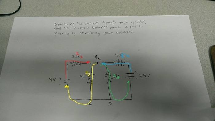

I am having trouble picturing how the current flows or the possibilities that the current could flow, is there any tips or ways to make that more clear?
from what I've read from the equations I am picturing this is what is happening, which I know is incorrect
Even were you right, in forming these equations we aren't interested in any current's full path.
We are applying Ohms Law to individual branchs (resistors). The 6 Ohm resistor has Vx volts across it, and its current is I2. That's all you need to know to form the equation.
As to your question, current goes from a higher potential to a lower potential. So if it goes from +Vx volts down to 0V, it's not going to then reverse and go from 0V back up to +Vx volts through another resistor. After reaching the ground wire (0V) current returns to the battery from whence it originated (and it's pumped back up to that battery's positive potential).
EDIT: the diagram you have just added, with coloured paths, is close enough.

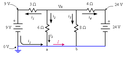

freshcoast, here's your circuit redrawn with points of interest indicated. The bottom rail (blue) is all one rail and is a convenient place to put our reference point for all potentials in the circuit. Hence the 0 V designation and the ground symbol on the bottom left.
The nodes at the top left and top right have their potentials fixed at +9 V and +24 V by the batteries (the batteries are directly between those points and the reference node).
Now, you're looking to find the current between points a and b assuming that in a real implementation of this circuit there would exist a wire corresponding to a-b. I've designated that current as I in the diagram. Consider point a as a node. How might you determine what I is?

Sum of current in = sum current out?
So with your diagram, I1 + I2 = I?
That's the idea. Now all you need to do is solve for I1 and I2. Hence the nodal analysis...
