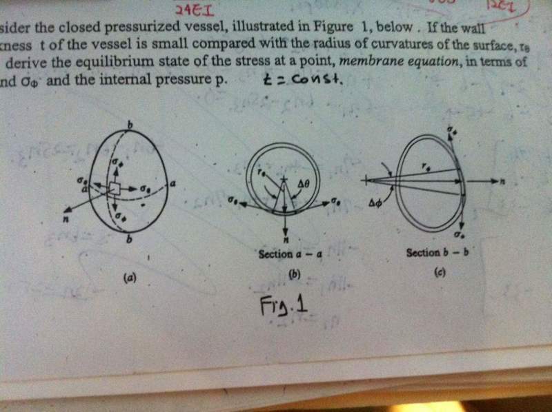

derive the equilibrium state of the stress at a point in a circular pressurized vessel, membrane equation, in terms of σ_a and σ_b and internal pressure b. Figure is picture of a thin walled pressurized elliptical vessel (like a sphere vessel except with horizontal diameter(a) not equal to vertical diameter (b)).
For a sphere, the equilibrium stress is denoted as pr/2t, with r being the radius and t being the thickness.
There are plenty of solutions available for the stress involving a spherical vessel, and for a cylindrical vessel, but I haven't seen anything for the elliptical one. Any help will be appreciated!

I included the image of the figure diagram given in the problem.
any further help will be appreciated.

iqjump123: The given problem can be viewed as a 2-D problem, because it is axisymmetric (identical) about the y axis. Therefore, you only need to solve a 2-D problem, involving one meridional ellipse (on the xy plane), as a function x or angle phi. You do not need angle theta.
The principal radii of curvature r1 and r2 are not the ellipse semi-axes. Parameters r1 and r2 are the principal radii of curvature of the ellipse at any angle phi (for r2) and delta-phi (for r1). Principal radius r1 is the ellipse radius of curvature (in the meridian plane) at any point. Principal radius r2 generates the shell surface in the direction perpendicular to the direction of the tangent to the meridian curve.
If you are not familiar with principal radii of curvature r1 and r2, study membrane stress on any surface of revolution (or shell of revolution), to learn what r1 and r2 are. And this will explain r1 and r2 better than I can. Afterwards, derive r1 and r2.

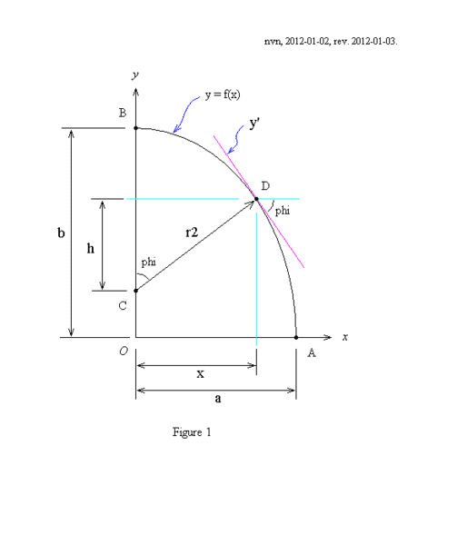

Because you have not made too much progress yet, I will go ahead and give you a big hint for deriving r2, just to get you started. Deriving r1 is more difficult than deriving r2; therefore, you can derive r1 later, as a separate task. First, derive r2, since it is slightly easier. Hint 2: See Fig. 1 in the attached file. Now, see if you can derive r2, as a function of x. Show your work, if you want us to check your math.

iqjump123: Variables h, phi, and point C are not known. They are variables, not constants. They are functions of x. You must write expressions for these unknowns, as a function of x.
Notice, in Fig. 1 in post 9, principal radius of curvature r2 always starts on the y axis, always ends at the ellipse, and is always normal (perpendicular) to the ellipse. Radius r2 generates circles in horizontal planes (because this is a surface of revolution).
Your radius r in your attached file in post 10 is not a radius of curvature. You can see, it is not normal to the ellipse.
Derive the length of radius r2, as a function of x, using Fig. 1 in post 9. Hint 3: Use trigonometry. Hint 4: Notice the pink line in Fig. 1. What does it tell you, and how can you use that to derive the length of r2, as a function of x? Show your work, if you want us to check your math.
