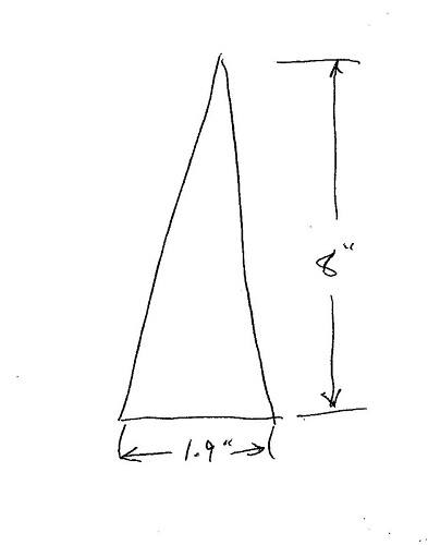

  • A 8 inch, 0.95 radius solid cone with an area of 26.88 square inches.

If I understand correctly, your penetrator cone is like this:
The "semi-vertical angle" is less than 7 degrees, while your linked paper only applies to angles in the range of 50 to 80 degrees. The paper does not apply to your situation. The small angle of your penetrator means that penetration forces will be significantly affected by friction, while the larger angles are chosen to minimize the effects of friction and maximize the effects of material properties.
The paper also assumes that the material will not fracture under worst case plastic strain. That rules out its application to granite, limestone, and sandstone, all of which are brittle materials. Materials like brass and steel have a wide range of properties, depending on exact alloy, strain history, and heat treatment. The paper is about finding those material properties by means of a penetrator test.
Yes that looks about right, and fair enough, like I say I did not fully understand it, the person who offered me the paper thought it would help because it talks about plasticity and I knew nothing about it period honestly.
