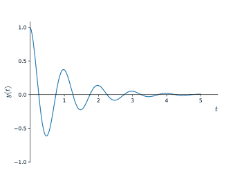

There is hysterisis loss in the webbing, the springs, the frame, in addition to an aerodynamic friction loss from the jumper herself as she moves through the air.
The trampoline system itself is an underdamped system, where the oscillations decay after some time.
This is evident in that if the jumper does not input energy into the system during the cast off from the net, the jump height decreases, and she eventually comes to a stop on the net - a built in safety net ( pardon the pun ).
Whether the energy loss from the movement of the air around the net as it deforms overwhelms the other hysteris losses is not evident. A simple knapkin analysis yielded about a 5 pound force loss from the air movement for a completely closed net given the 1m deflection of the net and 6 m/s jumper velocity.
An open net would necessarily involve a decrease, and for competion with a tuned trampoline vs home jumping from sloppy over the counter model( ie less height, more effort - again safety for non-professional jumpers ) , the open netting is probably welcome, although there is still the pressure drop across the open net to contend with.
Underdamped oscillation relaxation:
https://en.wikipedia.org/wiki/Damping

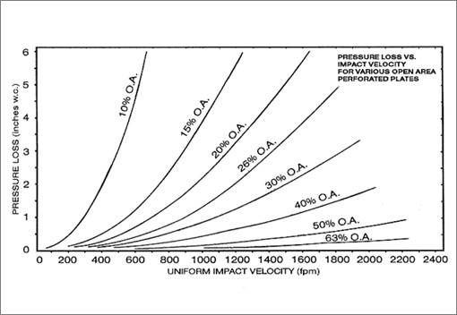

I would think that @russ_watters with his experience in HVAC air supply systems.
In fact this is no different than the pressure drop through say perforated ceiling tiles ( ASHRAE ), filters and/or orifices.
From this,
https://www.accurateperforating.com/resources/technical-information/pressure-loss
one can get an idea of what is being looked at.
Note that this is for a perforated plate in an enclosed duct, so thus not directly applicable.
Movement around the perorated plate is not possible.
It would be as if the bottom portion of the trampoline is fully enclosed.
If one uses 6 m/s air velocity ( only at the centre of the mat and only at the moment of impact from the falling jumper ), a vertical line from 1100 gives the pressure drop for various cases of open area of plate.
1 inch water column = 0,04 psi.
