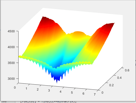

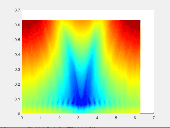

I have a likelihood function that has one global minima, but a lot of local ones too. I attach a figure with the likelihood function in 2D (it has two parameters). I have added a 3D view and a surface view of the likelihood function. I know there are many global optimizers that can be used to obtain the location of the global minimum point in the likelihood function. However, I want to know what basic optimizer principles that I can use (that I can also derive and implement myself) for a problem like this. If you see the 3D view, you may find many local minima. I am also open to suggestions that involve Bayesian type of optimization where I will get a posterior and not just a point estimate. I am open to that as well. I have tried MCMC type sampling optimization, however, they are computationally expensive. The number of parameters may increase later.
  • 3D surface plot of a likelihood function over two parameters, with a deep blue basin near the front-left and many small local dips along its edge; z-axis runs from 3000 to 4500.
  • Colour heat map of a 2D likelihood surface over x from 0 to 6.3 and y from 0 to 0.63, showing a single deep blue valley near x = 3.1 with many smaller ripples along the bottom edge and red high values at the top corners.
Is it literally just this function you want to optimize?
You already did it, by drawing a graph. More formally if that's unsatisfying, for low dimensions and fast evaluation functions you can just evaluate the function at every point on a fine grid and pick the point with the best value. If you want a little extra precision you can run any optimizer from there to find the local extremum near that point.
