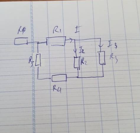

In the figure below, how can i apply current divider to find I3 ?
[tex] Ix = \frac{Rt}{Rt +Rx} I [/tex]
Should it be [tex]I3 = \frac{(R2+R4)}{(R2+R4) +R3} I[/tex]
or [tex]I3 = \frac{R2}{R2 +R3} I[/tex]

Ok i know the answer,
in this case R2 is not in series with R4 so the second answer is correct
If you set ##R_3=R_2## which of the two choices gives you the expected answer ##I_3=\dfrac{I}{2}##?

The second one
Right.
