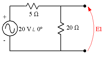

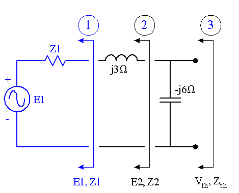

Your approach to finding the Thevenin voltage doesn't make sense to me. You want to find the open circuit potential at terminals a-b, yet your first step seems to "disappear" terminals a and b by incorporating the capacitor's impedance with the inductor's.
One approach to finding the Thevenin equivalent for this sort of layout, which I find useful, is to work from the source forward to the open terminals incorporating the components successively into a Thevenin model. So begin with just the voltage divider presented by the source and two resistors.
Here's a diagram where the first step has been completed:

Let's try going step by step in the manner that I proposed.
What do you get for E1 and Z1 considering only the original source and the resistor divider? (looking towards the source from the point of view (1) ).

Norton and Thevenin models are always interchangeable. But really, why would you go to the trouble of finding the Norton equivalent first when you've got such a simple voltage divider?
What's the Thevenin equivalent of the above?
Okay I see what you mean now; when finding VTh you can break them all up into other Thevenin models.RTh of only the 20 and 5 with the source is
(1/5 + 1/20)-1 = 4Ω
and then the VTh of that is
20*(20/25) = (16∠0°)V ?
Would the voltage division for the actual VTh of the problem then be
= (16∠0°)V*(-6jΩ/(4Ω + 3jΩ - 6jΩ) ?
= (16∠0°)V*(-6jΩ/(4Ω - 3jΩ)
= (16∠0°)V*(6∠-90°/5∠-36.8°)
= (19.2 ∠-53.2°)V ? Almost the same as I had originally.
Yup. That's the idea.
(1/5 + 1/20)-1 = 4Ω
Yes.
Yup. That's right.
