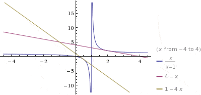

Here's a graph from WolframAlpha:
Thank you for the graph, but how were you able to graph multiple equations on one coordinate plane? I've only ever been able to do one at a time.
Here's a link to WolframAlpha with the parameters I used.
http://www.wolframalpha.com/input/?i=plot+x%2F%28x-1%29%2C-x%2B4%2C-4%28x-1%2F2%29-1
If you don't include the "plot" instruction, but just enter y=x/(x-1),y=-x+4,y=-4(x-1/2)-1, you get this: http://www.wolframalpha.com/input/?i=y%3Dx%2F%28x-1%29%2Cy%3D-x%2B4%2Cy%3D-4%28x-1%2F2%29-1
