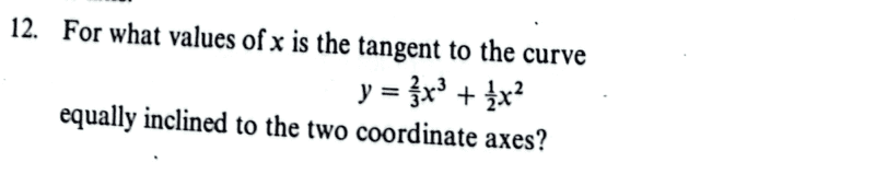

At what ##x## value is the tangent equally inclined to the given curve?

See attached.
differentiation.
I had to look this up; will need to read on it.
from my research,
https://byjus.com/question-answer/t...om-the-points-1-2-and-3-4-is-ax-by-c-0-where/
I have noted that at equally inclined; the slope value is ##1##.
##\dfrac{dy}{dx} = 2x^2+x=1##
##2x^2+x-1=0##
##x=-1## or ##x=0.5##
the steps are clear; but i need to understand the concept...i guess more reading on my part. ...just sharing in the event one has insight to offer. Cheers.

It's pretty straightforward. If you graph ##y = \frac 2 3 x^3 + \frac 1 2 x^2##, there are points in the first and third quadrants at which the slope is 1, namely, at (-1, -1/6) and (1/2, 5/24).

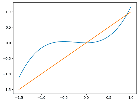

Just for reference, here is the plot of the function and the line ##y = x##.
Pretty suggestive that at x = -1 and 0.5 are the slope is indeed the same slope as ##y = x##.
