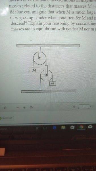

Masses M and m are connected to a system of strings and pulleys as shown
in the diagram below. The strings are massless and inextensible, and the p
ulleys are massless and
frictionless.
A: Find the accelerations for M and m (Hint: Think about these two questions:
Do these two masses have the same accelerations
in magnitude ? How is the distance that the lower pulley moves related to the distances
that masses M and m travels?)
B: One can imagine that when M is much larger than m, mass M would descend while mass m w goes up. Under what condition for M and m, would mass M go up while mass m descend? Explain your reasoning by considering the static situation (i.e., when the two masses are in equilibrium with neither M nor m moving)
Sum of Forces=ma[/B]
I said F= the sum of forces for just one of the masses and solved for a. Doing this for both masses, I got two separate accelerations, and then I realized that the two masses are connected. I know this isn't right because the two masses are connected by the strings somehow but I can't conceptually picture this.[/B]

Hello Rod, :welcome:
For this reason you are given hints in the form of two questions. What are your answers?
You get a third one from me :smile: : can you imagine an equilibrium situation ? If so, under what condition ?
[edit] reading ahead can be profitable (for folks like me too :rolleyes:): the same question is asked in part B.
