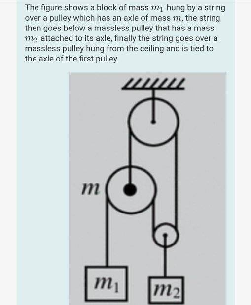

the arrangement in the figure
sum(F)=ma
in the opposite problem that has three pulleys and two masses, the book is asking for :
1- the tension on the string.
2- the acceleration of pulley p1.
3- the acceleration of mass m2.
4- what should the mass "m" be such that m1 does not accelerate?
note : pulley p1 has mass m, in the diagram of P1 there should be mg also along with T on pulley 1 , I assume!

I just want to check my answer or if I am missing something, thanks in advance.

This is not sufficient information about the pulley unless additional assumptions are made about the moment of inertia of that pulley.
What “the opposite problem” is?
Are you sure about the pulleys having mass?
the problem shown in the figure is exactly similar problem that I found online for the free body diagram only, but my problem states the following :
Diagram of a pulley system: a fixed ceiling pulley, a movable pulley with axle mass m supporting block m1 on the left, and a small pulley with axle mass m2 supporting block m2 on the right, connected by a string.
The text of this problem specifies the mass m to be on the axle of the pulley. Effectively givibg it zero moment of inertia. This makes it solvable.
my bad, I miss wrote that the pulley itself has mass m, so is my approach for the solution correct

You may want to rethink this:
patric44 said:
3-
2T-T-mg=ma_{p1}\quad,\quad a_{p1}=T/m-g
Which direction are you taking as positive? In which direction do the forces act?
should this be, assuming the up is positive
T-2T-mg=ma_{p}\quad,\quad a_{p}=-T/m-g

You have forgotten to include the axle’s weight on the FBD for p1.
When giving each object’s ‘F=ma’ equation, you appear to be using a sign-convention where the positive direction is taken to be the assumed direction of acceleration. I think (not sure) that this will be OK - but it would mean your ‘F=ma’ equation for p1 is wrong.
You haven’t given the ‘F=ma’ equation for p2.
Since the string length is constant, there is a relationship between ##a_1, a_2, a_{p1}## and ##a_{p2}##.

yes that's the convention I used, I guess it should be (I am some how confused about the direction of the acceleration) I will assume that both of them will go down ,then for P1
2T+mg-T=ma_{p}\quad, a_{p}=T/m+g
and for the second pulley P2
T_{2}-2T=m_{p2}a_{p2}\quad, T_{2}=2T

Looks right so far. What about the kinematic relationship between the accelerations that @Steve4Physics mentioned?

This should already tell you something about the possibility of the system being in equilibrium. So this
patric44 said:
now for a_{1} to equal zero the system will be in equilibrium and
cannot be the case. However, you may be able to find a setup such that ##a_1 = 0##, but that will not mean the system is in equilibrium.

I assumed that since m1 is not accelerating say downward, it will not lift the other mass m2 at the other side, how could m1 not be accelerating but m2 is ?

can you give me a little hint on how to use the length in that situation? 🤔
Are you familiar with how the string being a fixed length is used in the treatment of the regular Atwood machine?
Assign variables to each straight segment of string.
Write equations representing that each whole string is of constant length.
Differentiate as necessary to get accelerations.
