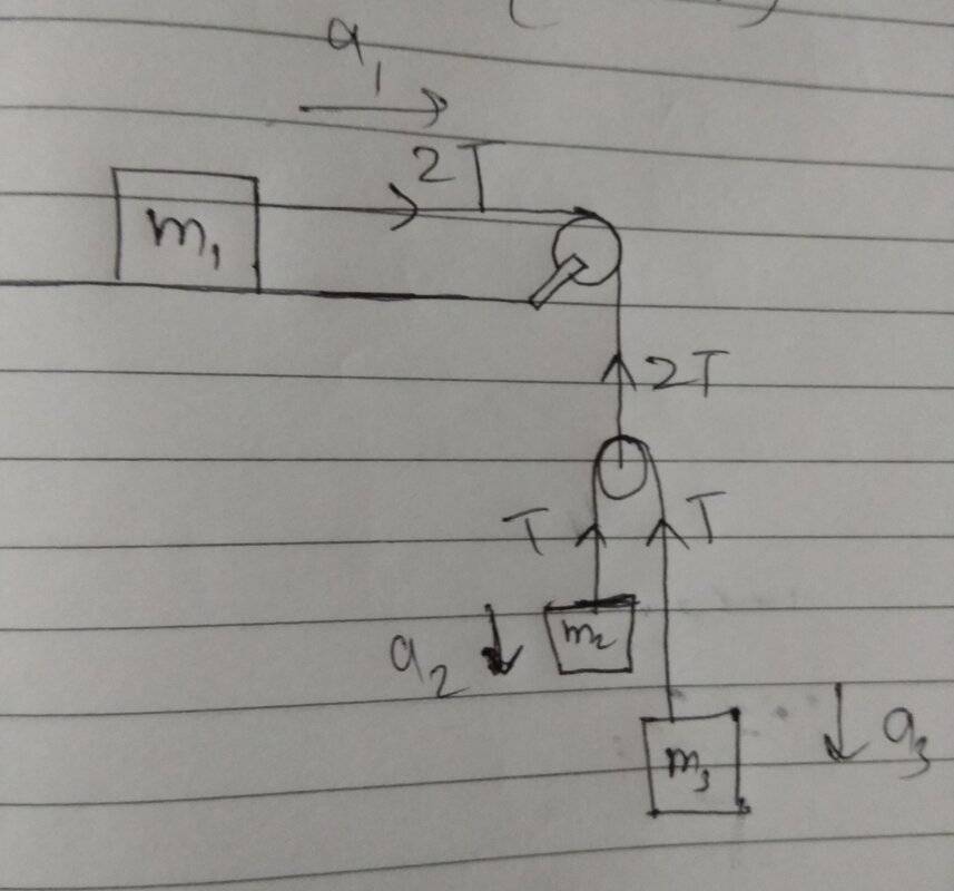

Three blocks of masses m1, m2 and m3 are connected as shown in the figure. All the surfaces are frictionless and the string and pulleys are light. Find the acceleration of the block of mass m1.
2T=m1a1
m3g-T=m3a3
T-m2g=m2a2
a2+a3=2a1
Since 2nd pulley accelerates downward with the same acceleration of m1, and because the string around pulley has a constant length, it must be that a2=−a1+ar and a3=−a1−ar, where ar is the relative acceleration between the pulley and m2.
From the above 4 equations, we are supposed to determine the effective mass pulling on m1 by comparing to the case where the 2nd pulley system is replaced with a single hanging mass. In my opinion the effective mass should be m2+m3 but it is given as
m(eff)= 4m2m3/(m2+m3)
I know that
m(eff)*g - 2T=m(eff)a1
[m(eff) + m1]a1 = m(eff) *g
But how to find m(eff)
Crystal037 said:
a2=−a1+ar
Your diagram indicates you are taking a1and a2 as positive down, so why -a1?
What if ## m_3 \approx 0 ##? Clearly the answer of ## m_{eff}=m_2+m_3 ## is incorrect.

Solve the system of four equations for m1 and then use the last two equations to determine m(eff).

No, what you had in post #5 was probably fine, but you need to define which way you are taking as positive for ar, up or down?

If you let ##m_3 \rightarrow 0 ##, then ## m_2 ## will accelerate with value ## g ## downward, (pulling the almost massless ##m_3 ## upward), and ##m_2 ## will not pull downward on the system.
Then how should I approach to find the m(eff)
Find the ## m_{eff} ## that when attached to the system, it causes an acceleration of ## a_1 ##. Have you computed ## a_1 ## yet? If you attach ## m_{eff} ## to the system, then ## a_1=(m_{eff}g)/(m_1+m_{eff} )##. Set that equal to your ##a_1##.
One correction for you: In your set of equations in the OP, the third one should read ##m_2g-T=m_2 a_2 ##. If you solve those for ##a_1 ##, you should get a correct answer. I solved them, and it did lead to a correct ## m_{eff} ##.## \\ ## I'd be happy to check your expression for ## a_1 ##, if necessary. ## \\ ## The 4th equation is actually the trickiest of the bunch, and you have that one correct.## \\ ## Edit: One other item, is that for your ## a_r ## equations, you need a plus sign on both ## a_1 ##'s, but you seemed to correct that by writing the 4th equation correctly.

Have you found a1? If yes, you get m(eff) from your equation [m(eff) + m1]a1 = m(eff) *g in Post #1

By solving the actual set-up to find T then using that in the equations you wrote in post #1.
But I ask again, which way are you defining as positive for ar?
Btw, it is worth explaining why the effective mass is not m2+m3. The common mass centre of m2 and m3 will accelerate downwards, so it exerts less pull on the upper cord than ( m2+m3)g.

I am defining the ar as vertically downwards
Then what you had in post #5 is still wrong.
Suppose you were to hold m1 still so that a1 is zero, but ar is positive. Would a2 be positive or negative?
What if ar is zero? What would be the relationship between a1 and a2 then?

You have enough number of equations to get all accelerations, tensions, and even an effective mass. You decide, in what order you calculate them. You can eliminate all unknowns but the effective mass if yo like.
