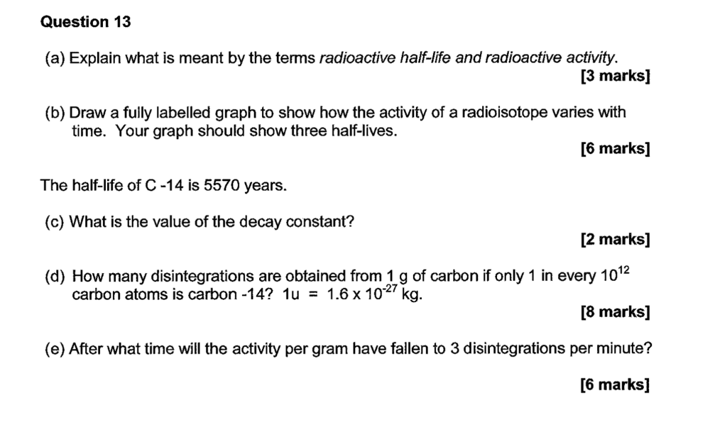

See full question below
A = Lambda*N

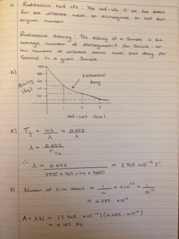

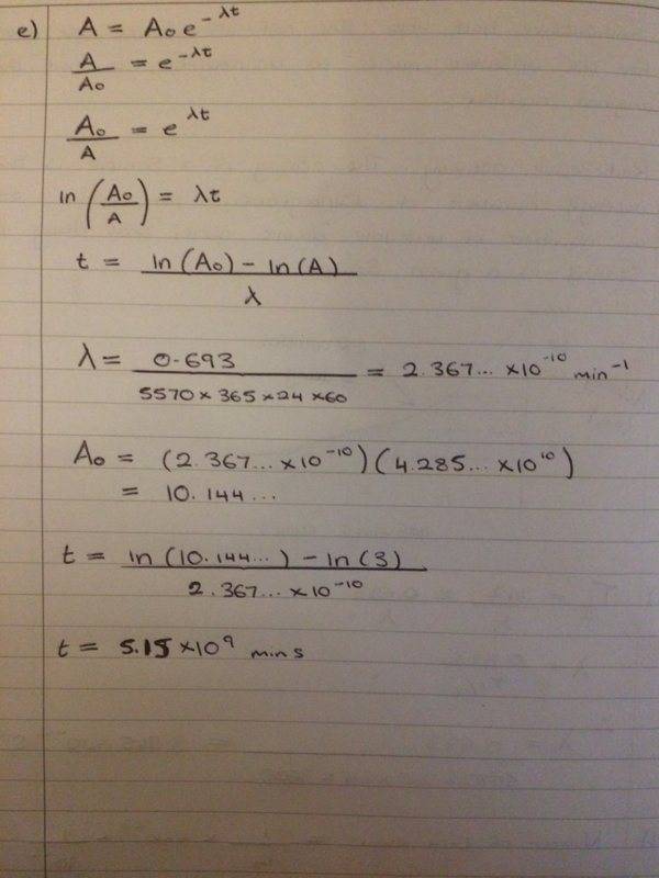

Hi there
So I have had a go at this question but I'm not confident that I have done the last 2 parts of this question right?
Can anyone please see if this is what you do to get the values?
Any help would be appreciated! Thanks
Think again about how you calculate the number of C14 atoms in the 1g.

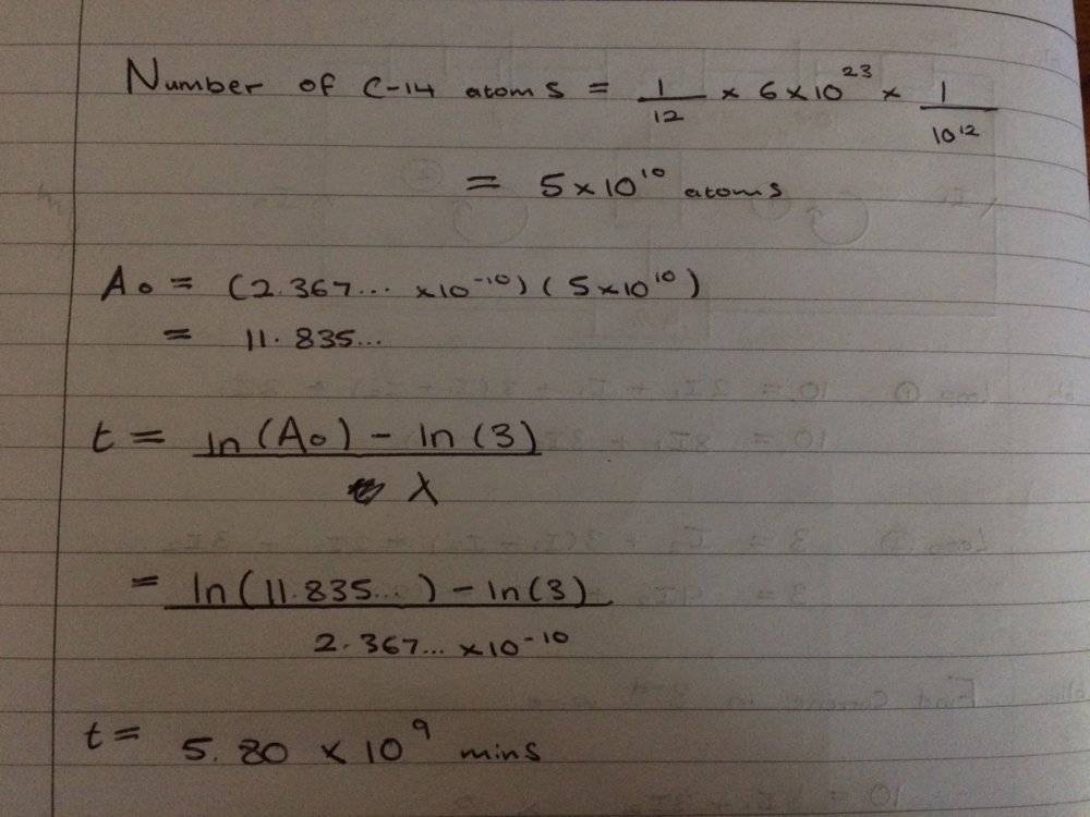

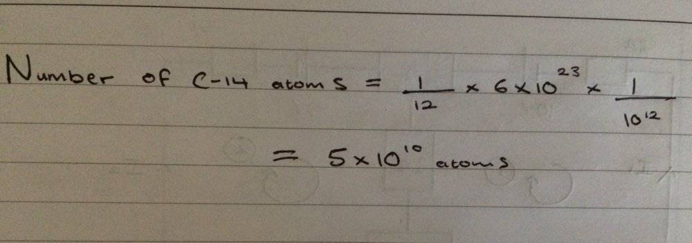

Is this what I should get instead?
I don't know why I was using 14 as the molar mass of carbon-12
That appears to be a good enough approximation considering the huge excess of carbon-12, good enough for the precision of my calculator, anyway!
If the proportions were less extreme, you'd need to perhaps consider using a weighted mean or else an algebraic expression of some sort for the relative masses.
Thanks I understand, and notably this means my answer will be affected for part e) as part e) relies on part d)
I changed it now and found the time that the activity will reduce to 3 disintegrations per min assuming 11.835... is the initial activity in disintegrations per min
