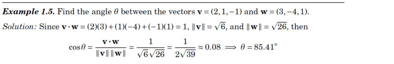

See attached;
sine and cosine angle rules
This is clear to me; i just wanted to know in which contexts is one allowed to use one rule over the other; or it does not matter.
The angle i realise can also be found by;
##\sin θ = \dfrac{||v×w||}{||v||||w||}##= ##\dfrac{||-3i-5j-11k||}{\sqrt{6}\sqrt{26}}##=##\dfrac{\sqrt{155}}{\sqrt{6}\sqrt{26}}=0.99679## to 5 decimal places...
##⇒θ=\sin^{-1} [0.99679]= 85.41^0##
In which contexts is one allowed to use sine angle rule? ; or is it dependent on the question as directed? cheers...
I picked my own example as follows let;
##p=2i+3j## and ##q=3i+4j## then;
##\cos θ= \dfrac{18}{\sqrt {13}\sqrt{25}}##
##θ = cos^{-1} [0.99846]=3.18^0## to two decimal places
and extending it to ##\mathbb{R^3}## we shall have;
##p=2i+3j+0k## and ##q=3i+4j+0k##
on using cross product we shall end up with,
##\sin θ =\dfrac{1}{\sqrt{13}\sqrt{25}}=0.05547## to 5 decimal places...
##⇒θ=\sin^{-1} [0.05547]= 3.18^0##
chwala said:
Homework Statement:: See attached;
Relevant Equations:: sine and cosine angle rules
It does not matter. In most cases I prefer cos because I can calculate inner product easier than vector product.
