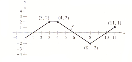

http://www.webassign.net/larson/4_03-48.gif
a) integral -4f(x) from [0,1] using that graph
i really have no idea what to do. i understand integrals but not with agraph? what is it asking me?
Hint: An integral within an interval is the same as computing the area within that same interval.
so from [0,1] it is just 1/2bh? wouldn't that be just 1/2 x -4?
Numerically, the integral would be -1/2 since the height is at '-1'. So it would be -1/2*-4 I believe.
what about from [0,7] with the integral being 8f(x)dx
i did 1/2(7)(1+5)(8) which was wrong. what did i do wrong?
For [0,8] , you have
A triangle in [0,1]
a trapezium in [1,6]
a triangle in [6,8]
So you need to compute the areas there and add them up.
