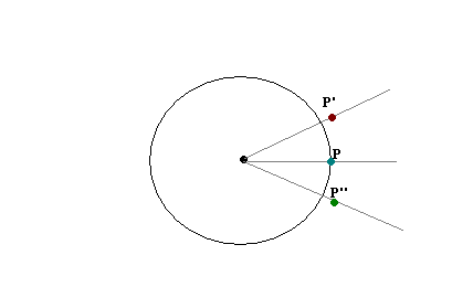

TSny said:
Pick an arbitrary point P' in the plane and consider a radial element of current at P'. Consider the B field produced at P by this current element at P'. Then pick another point P'' in the plane with a location that is "symmetrically related" to the location of P'. (You decide the location of the symmetrically related point P''.) Consider the B field at P due to a current element at P''.
Please see the attached image .
Do you think I have marked the symmetric points correctly ? The line joining them is perpendicular to Y axis .
Yes, but your choice of P' and P'' looks too special since it appears that these two points have the same x-coordinate as the point P.
I think for any point on the loop , the line joining the three points will be perpendicular to the line joining the center and point P .
Right?
Right?
I'm not quite following you. Point P is located above or below the plane that carries the current. Points P' and P'' lie in the plane. So, the three points do not lie on the same straight line. For example, point P could have coordinates (x, y, z) = (5, 0, 4). Point P' might have coordinates (3, 2, 0). Then what would be the coordinates of P''?
Coordinates of P" would be (3 , -2 , 0) .
In general if O is the point where wire meets the plane and a perpendicular is dropped from P on to plane . The point where the perpendicular intersects the plane is M . For any point P' on the plane there would be a symmetric point P" on the plane such that OP' = OP" and ∠P'OM = ∠P"OM .
For example , at any point P (3,3,5) , if we consider P' to be ( 2 , 0 ,0 ) , then P" would be (0 , 2 , 0 ) .
Is that correct ?
Yes
Is that correct ?
Yes, that's right.
