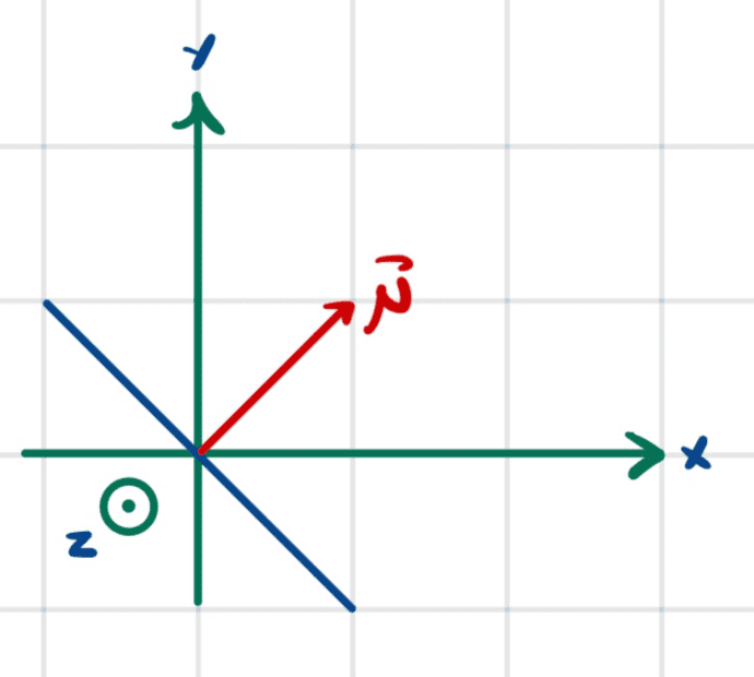

This question is about considering a magnetic dipole moment located at the origin of a coordinate system under effect of a magnetic field ##\vec{B}##. For different definitions for ##\vec{B}##, we need to find the net torque and the resultant force.
This is a problem from MIT OCW's online course 8.02. There is an automated solution system, but it only tells me what is wrong, not why. Thus, I spent an enormous amount of time today on this one problem without making too much progress.
Consider the following scenario.
We have a closed current loop (say a rectangular loop to make it easier) with magnetic dipole moment ##\vec{\mu}## shown below.
We have a magnetic field ##\vec{B}## which will be defined in different ways below.
I think it is easier to visualize as follows
Where the blue line represents a side view of the current loop.
Let
$$\vec{\mu}=\mu_C(\hat{i}+\hat{j})$$
where ##\mu_C## is a positive constant.

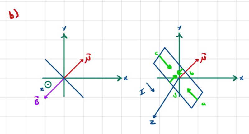

At some point I decided to do the calculations assuming that the current loop is rectangular.
The blue line in the picture above would then be one of the sides, and there would be two sides perpendicular to the screen (one with current going into the screen and the other with current coming out of the screen).

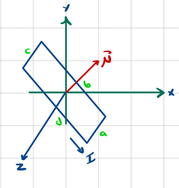

Here is another view
As far as I can tell, for this problem (in which ##\vec{B}## is always in the ##xy##-plane) the only sides that contribute to net torque are (a) and (c) above. The forces on (b) and (d) cancel out in terms of torque and in terms of just their sum. Is this actually true? I did not try to do actual calculations, I simply contorted my right hand to figure out the right hand rule cross product for each piece of (b) and (d) in each case for ##\vec{B}##.
For each case, I carried out the calculation
$$d\vec{F}_a(x,-x,z)=Id\vec{s}_a\times \vec{B}(x,-x,z)=Idz(-\hat{k}) \times\vec{B}(x,-x,z)$$
$$d\vec{F}_c(-x,x,z)=Id\vec{s}_c\times \vec{B}(-x,x,z)=Idz \hat{k} \times\vec{B}(-x,x,z)$$
$$\vec{F}_a= \int_a d\vec{F}_a=\int_{-l}^l \left (Idz(-\hat{k})\right )\times\vec{B}(x,-x,z)$$
$$\vec{F}_c=\int_c d\vec{F}_c=\int_{-l}^l (Idz\hat{k})\times\vec{B}(-x,x,z)$$
and then
$$\vec{\tau}=\int_a \vec{r}_a \times \vec{F}_a+\int_c \vec{r}_c\times\vec{F}_c$$
$$=\int_{-l}^l (x\hat{i}-x\hat{j}+z\hat{k})\times \vec{F}_a=\int_{-l}^l (-x\hat{i}+x\hat{j}+z\hat{k})\times\vec{F}_c$$

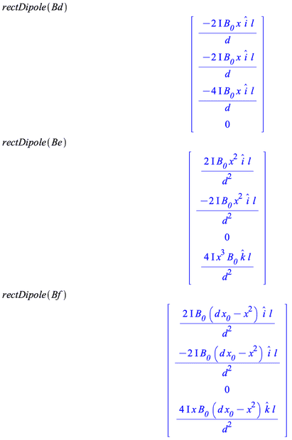

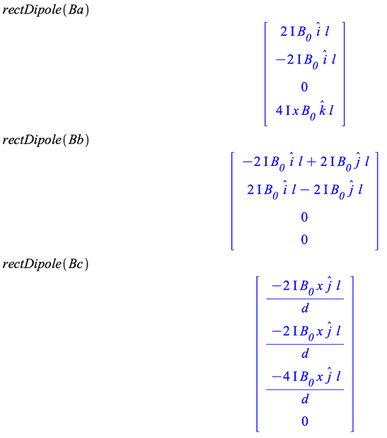

Following are the results for each case.
Note that in each case, I am showing an array. The entries from top to bottom are ##\vec{F}_a, \vec{F}_c, \vec{F}_a+\vec{F}_c##, and ##\vec{\tau}##.
Note that ##x>0## and that ##x## is a constant.

My answer to these questions for the specific case of a rectangular loop are
1) (a) and (e). Also, (f) if ##x^2<dx_0##.
2) Only (f) when ##x^2>dx_0##.
3) (b), (c), (d)
4) None
5) (d)
6) None
7) (c)
8) (a), (b), (e), (f)
The solution system says 1), 3), 4), and 7) are incorrect.

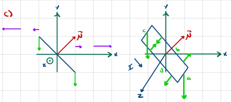

In case (c) here is what I can see
Note the purple arrows on the left picture shows ##\vec{B}##. The magnitude increases as ##x## increases, and the direction depends on whether ##x## is positive or negative.
The forces on sides (b) and (d) cancel as far as I can tell.

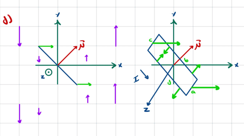

Here is case d)
Again the forces on (b) and (d) seem to cancel.

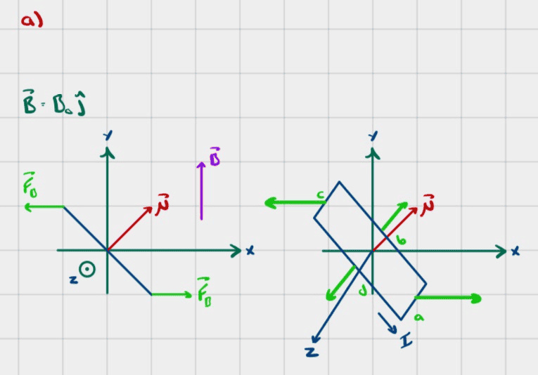

Here are cases a) and b)

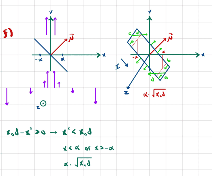

Here is my little diagram for case f) btw

@haruspex Let's just consider case f).
I just want to make sure of one thing. ##x_0>0## is a parameter in the definition of ##\vec{B}## and ##x## is an independent variable in this definition.
Therefore, is it not true that for a rectangular loop (with sides (a) and (c) having ##x##-coordinate ##x_1## and ##-x_1##, for ##x_1>0##) the net torque depends on the relationship between ##x_0## and ##x_1##?
Do you agree with this statement?
In particular, if ##x_1>x_0## then torque is in ##-\hat{k}## direction, and if ##x_1<x_0## then torque is in the ##|hat{k}## direction.
I agree with all that in regard to a and c, except that it also depends on the parameter d as you noted in post #1. I.e. ##x_1^2<>x_0d##.
For b and d it is more complicated since the torque varies along them. In particular, for ##x_1^2>x_0d## the torque is one way at their ends and the other way at their centres. Thus the boundary value for ##x_1^2##, where the net torque switches sign, will be a bit greater than ##x_0d##.
However, as I wrote, I think you should be considering the limit ##x_1\rightarrow 0##.
I went through my limit method. It says, as I rather suspected, that c, d and e all give zero torque because the field at the origin is zero.
If that is wrong then I have no idea what the question means. But it is consistent with the marking you got on 1, 2 and 3.

kuruman said:
I think the intent of the problem is to have a point dipole moment at the origin.
Yes, that is the view I have been pushing.
kuruman said:
Torques and forces are to be calculated using, respectively, ##\vec {\tau}=\vec m\times \vec B## and ##\vec F=\vec {\nabla}(\vec m\cdot \vec{B}).#
What about the model choice for the dipole mentioned at the link I posted in #17?
I looked at the Abstract of the article. I have not read the body of the article so I cannot see the difference between ##\mathbf{F}=\mathbf{\nabla}(\mathbf{m}\cdot\mathbf{B})## and ##\mathbf{F}=(\mathbf{m}\cdot\mathbf{\nabla})\mathbf{B}.##
It seems to me that if one uses the product rule identity and the fact that the dipole moment has no spatial dependence, $$\mathbf{F}=\mathbf{\nabla}(\mathbf{m}\cdot\mathbf{B})=(\mathbf{m}\cdot\mathbf{\nabla})\mathbf{B}+\mathbf{m}\times\left(\mathbf{\nabla}\times\mathbf{B}\right).$$ So far so good. Perhaps here is where the model enters the picture. If I think of ##\mathbf{m}## as the magnetic dipole of, say, an electron, then there is no current ##\mathbf{J}## anywhere and, by Maxwell's equation, ##\mathbf{\nabla}\times\mathbf{B}=0.## Hence, $$\mathbf{F}=\mathbf{\nabla}(\mathbf{m}\cdot\mathbf{B})=(\mathbf{m}\cdot\mathbf{\nabla})\mathbf{B}.$$ Maybe I will read the article tomorrow. It's late where I am and I have to sign off before I say anything stupid.
##\vec m=\mu(\hat i+\hat j)##
In case d), ##\vec B=-x\hat j##
##\vec m\cdot \vec B= -\mu x##
##\nabla(\vec m\cdot \vec B)= -\mu \hat i##
##\vec m\cdot\nabla=\mu(\frac{\partial}{\partial x}+\frac{\partial}{\partial y})##
##(\vec m\cdot\nabla)\vec B=-\mu\hat j##
Do I have something wrong?

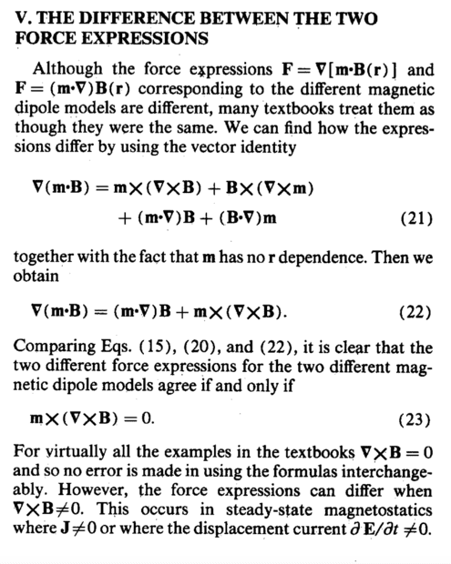

Not really wrong. Just incomplete. I read the article and I show below a screenshot of the relevant excerpt.
With ##~\mathbf{B}=-\dfrac{x}{d}\mathbf{\hat j}~## and ##~\mathbf{m}=\mu(\mathbf{\hat i}+\mathbf{\hat j})##,$$\mathbf{m}\cdot\mathbf{B}=-\dfrac{\mu~x}{d}\implies \mathbf{\nabla}(\mathbf{m}\cdot\mathbf{B})=-\dfrac{\mu}{d}\mathbf{\hat i}$$ as you found (for ##d=1##).
It is also true that ##~(\mathbf{m}\cdot\mathbf{\nabla})\mathbf{B}=-\dfrac{\mu}{d}\mathbf{\hat j}~## as you found.
However, to complete the picture, there is an additional term to be calculated. $$\mathbf{\nabla}\times(\mathbf{\nabla}\times\mathbf{B})=\mu(\mathbf{\hat i}+\mathbf{\hat j})\times(-\frac{1}{d}\mathbf{\hat k})=\frac{\mu}{d}\mathbf{\hat j}-\frac{\mu}{d}\mathbf{\hat i}.$$Therefore $$\mathbf{\nabla}(\mathbf{m}\cdot\mathbf{B})=-\dfrac{\mu}{d}\mathbf{\hat i}=(\mathbf{m}\cdot\mathbf{\nabla})\mathbf{B}+\mathbf{\nabla}\times(\mathbf{\nabla}\times\mathbf{B})$$ which verifies the identity.
This confirms that my assertion in post #20 that ##\mathbf{J}=0## was unwarranted. Although the problem does not mention currents, I should have seen that the curl of the magnetic field is non-zero. The moral of the story here is "use ##~\mathbf{F}=\mathbf{\nabla}(\mathbf{m}\cdot\mathbf{B})~## and you can't go wrong."
Thank you for posting the screenshot of the problem.
zenterix said:
I also think that this is the intent of the problem.
Then forget the rectangular current loop. Use the solution for part (d) above as a template.
