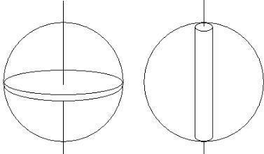

Is it correct to say that the process by which you arrive at the moment of inertia for a sphere and many other objects is to first break the object down into volumes whose moments of inertia are known (like cylinders or cylindrical discs), and then add up all those moments of inertia to find the moment of inertia of your entire object?
I'm trying to follow the way they arrive at the moment of inertia for a sphere on HyperPhysics. They seem to be adding up the moments of inertia for a bunch of discs stacked on top of one another (like in the sphere on the left in the attachment). Would it also be correct to instead add up the moments of inertia for a bunch of cylinders wrapped around the axis of rotation? (like the sphere in the right in the attachment.)
if you look at the formula, I=\int r^2dm, it's easy to see that basically you are adding up all the moments of inertia of all the point masses that comprise the whole mass (for a point mass, I=mr^2). so as long as whatever method you use to break down the mass (discs, cylinders, etc.) accounts for every point's moment of inertia, then it should come out with the correct answer. i find it is easiest to integrate the formula for distance to the axis of rotation squared times the density over the volume of the object.

Since "moment of intertia" involves solids, multivariable calculus is the correct place to look.
As Doc Al pointed out- the "r" in calculating moment of inertia is distance from the axis while the "r" in the sphere is distance from (0,0,0). It is almost always best to set the problem in cylindrical coordinates with the z-axis along the axis of rotation.
In cylindrical coordinates, x2+ y2+ z2= R2 becomes r2+ z22= R2.
