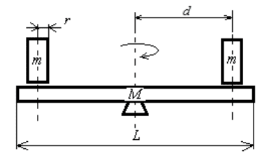

A bar of length ##L##, width ##a## and mass ##M## revolves around its center, with 2 cylinders of radio ##r## and mass ##m## anchored to each of its ends at a distance d from the center of the bar. Considering the parallel axes theorem, determine the moment of inertia of this system.
##I=\int r^2dm##
242283
I first tried to calculate the moment of inertia of the bar. The problem is that I don't understand exactly how are the dimensions of the bar. The fact that it has a width ##a## means that its height is ##a##, or that it has an unknown height and the width is ##a##, like a parallelepiped? After that I must calculate the moment of inertia of the cylinders with respect to the axis, right? so I can apply the Steiner theorem. The moment of inertia of the cylinders with respecto to their own center of mass is ##\frac{1}{2}mr^2, right? Now, how do I calculate the moment of inertia of the bar in ordder to apply the Steiner theorem?
If you assume that the width is into the page, then that is going to get complicated. It's difficult to tell whether that's what's intended.
But, I think you knew that already.
Davidllerenav said:
The fact that it has a width a means that its height is a, or that it has an unknown height and the width is a
Since you are given the mass, not the density, the height will not affect the MoI. So it is safe to assume it is horizontal width (into the page). It's not much more complicated than a simple thin rod.
Do you know the formula for the MoI of a rectangle about an axis normal to its plane?

Ok, once I get that I need to use the Steiner theorem to calculate the moment of inertia of the cylinder with respect to the bar axis, right?
The Steiner theorem might be useful before then.
Where?
You've got to do some of the thinking for yourself!
I don't know where thw theorem is useful before, but I calculaged the moment of unertia of the cylinder with respect to the center of mass of the bar like this: ##I=I_C+md^2=\frac{1}{2}mr^2+md^2##, thus the moment of inertia of the whole body is ##I_T=\frac {1}{12}M (L^2+a^2)+2 (\frac{1}{2}mr^2+md^2)=\frac {1}{12}M (L^2+a^2)+mr^2+2md^2##. Am I correct?
