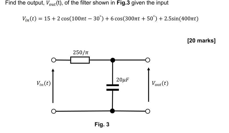

To calculate the output V of a filter given the Vin equation
See image below
Hi everyone, I've been having trouble on how to answer this question
Circuit schematic of a low-pass RC filter: a 250/π resistor in series between Vin(t) and Vout(t) terminals, with a 20µF capacitor shunting the output node to the bottom rail; labelled Fig. 3.
