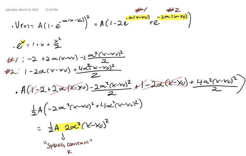

This problem had me take the taylor series of the Morse Potential,
until I got the first non zero term.
My result was U(x)=Aα2(x-x0)2.
I know to find the quantum number I can use En=(n+1/2)ℏω and I know I can relate that to the potential energy of a harmonic oscillator, 1/2kx2. So if this taylor series is similar to the PE of a H.O. I can just substitute that.
The problem is my taylor series is off by a factor of 1/2, so it doesn't resemble the PE of a Harmonic Oscillator.
Can anyone help me see where I am going wrong.

First check your algebra.
I don't understand the 1/2 discussion...you just redefine the constant. But there is a much bigger problem.
Your use of the correspondence to the Quantum oscillator is a good idea done badly. The value of the classical potential energy is essentially not related to the energy of the quantum eigenstrates. What does remain the same is the identification of ##\omega## from the respective equations. So what is the value of ##\omega##?

You need to to identify the "spring constant" k for the Morse potential near its bottom. This has nothing to do with QM or ħ.
Once you have that you then know ##\omega=\sqrt {\frac k m}##
I THINK I get what you are trying to say, so here is my attempt at identifying k.
Does this seem correct?
Looks good (I didn't check the Algebra). Remember that it is the "reduced mass" that appears in both the quantum and classical problem when written in the center of mass frame so I should have written ##~~\omega=\sqrt {\frac k {\mu}}##.

So I ended up getting En=(n+1/2)ℏ##\sqrt{Aα^2/μ}##
Does that seem correct?
I think that is what the problem is looking for. This is a little bit tricky depending upon how you define the zero of energy for the system. Also the Morse potential can be solved...but that is not introductory physics on any planet. You should (always) check that your result has the units of energy (I think it does)
