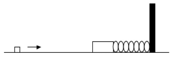

A small cube, with a mass of 2 kg, slides along a frictionless horizontal surface at a constant speed of 20 m/s until it collides with, and sticks to, a large wooden 5 kg block. The large block is attached to the left end of a spring with a spring constant of 75 N/m as shown in the diagram.
Diagram of a small cube moving right at speed on a frictionless floor toward a large block attached to a spring, which is fixed to a vertical wall on the right.
a. What is the momentum of the cube before the collision?
b. What is the kinetic energy of the cube before the collision?
c. Find the speed of the combined cube and block system just after the collision.
d. Find the kinetic energy of the cube-block system just after the collision.
e. What is the maximum potential energy that can be stored in the spring due to this collision?
f. How far will the cube-block system move before it stops?
PE= 1/2kx2
1/2kx2=mgd
d=1/2kx2/mg
I have a question regarding a problem that I am trying to solve. I successfully have completed a,b,c,d and am having trouble with e and f. To find potential energy, 1/2kx2, I know the k value, but there is no x given in the problem. Is there another formula to use to solve? For f, I have the equation ready to go, but again I need to know x. For f, my equation is d=1/2kx2/mg.
Much thanks and appreciation.

Thank you.
KE = PE
1/2kx2 =1/2mv2
1/2(75)x2 =1/2(7)(5.71)2
x2=2(114.11)/75
x=1.749m
Solve for E
PE=1/2kx2
PE=1/2(75)(1.749)2
PE=114.7 J
Solve for F
d=1/2kx2/mg
d=114.7/7(9.8)
d=1.67 m
Is this the right track, or are there still errors I am making?
Thanks again!
rocky4920 said:
Solve for F
d=1/2kx2/mg
I do not understand what you are doing here. How does gravity come into it? This is all on a smooth horizontal surface.
You already found the answer as x.
