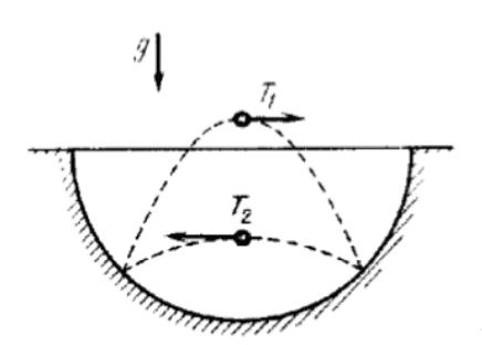

kaspis245
189
In a spherical bowl a small ball is jumping around. The ball hits the bowl in two spots and moves in two different trajectories in times T1, T2. Find the radius of the bowl.
Newton's laws of dynamics.
The only thing I could figure out is how the horizontal velocities of different trajectories are related:
[tex]s=v_{x1}⋅T_1=v_{x2}⋅T_2 ⇒ \frac{v_{x1}}{v_{x2}} = \frac{T_2}{T_1}[/tex]
But I can't find a way to get any expression with the radius. Please help.

What do you know about the incoming and outgoing angle for a perfectly elastic collision?
Unrelated to that: You will probably need the trajectories in both parts.

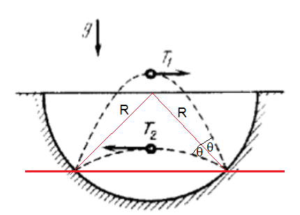

The ball interacts with the bowl which is much bigger than the ball. You can consider the bowl of infinite mass. The velocities are not the same, but energy might be conserved. What would it mean for the speeds?
The ball performs two different projectile motions with the same range.
that means the ball repeats its motion, so the collisions can be considered elastic.
The ball has both horizontal and vertical components of velocity. It jumps higher if the vertical component is bigger.
T1 and T2 are the times between two collisions with the bowl.
