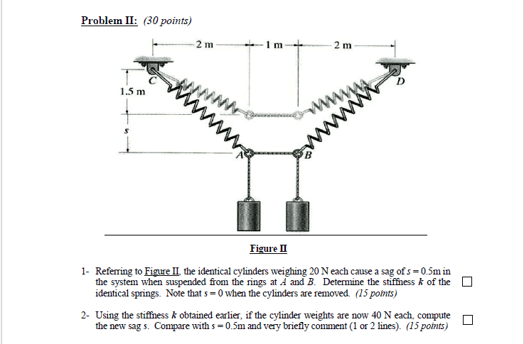

I've been trying to solve an exercise from my statics course and just couldn't get anywhere.
Basically it's a system of two springs connected by a rope, and each spring is attached to a cylinder (Both Cylinders have same mass).
The question is on question number 2 in the attached file, it requires that we calculate the sag caused by the two cylinders when they weigh 40N each.(Stiffness has been already calculated from question #1)
The attachment also views the lengths given by the problem
Here's a thumbnail of the problem
Well it's equilibrium so no other equations than ΣF=0
Pythagorus in a right triangle
Hook's law T=k∇
Some trigonometry..
