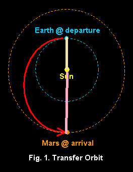

Hi, I have a question on my homework that I'm absolutely stuck at. I'm not sure how to go about this. Can someone help me through the steps to solve it? there are more after this similar to it so learning how to do this one would help me do the other ones by my self. Thanks a lot!
Your trip to Mars is accomplished by using an elliptic transfer orbit going from Earth to Mars as shown in Fig. 1. This trajectory assumes that Earth at departure, the Sun, and Mars at arrival, are aligned. Also, we will assume that Earth's and Mars' orbits are circular, with radiuses R = 149,943,160 km and 228,189,693 km, respectively.
What is, in meters, the semi-major axis, a, of this transfer orbit? Hint: determine its radiuses at aphelion and perihelion.

The hint asks for the radii at aphelion and perihelion.
What are those two values?
The major axis is the long axis of the ellipse that describes the transfer orbit. Can you work out the length of the ellipse given the orbital radii of the starting and ending points of the transfer curve?
It looks as though Gmp is meant to be G*Mp, where G is Newton's gravitational constant and Mp the mass of the primary in the system (In your problem it's the Sun).
I think I need to find out the aphelion and perihelion but I am not sure how.
And gneill, I'm not exactly sure what you're asking but If you mean the radius that the ellipse makes, would it be the diameter of Earth's orbit + the radius of mar's?
The orbits are circular according to the problem statement, so aphelion and perihelion are not needed.
gneill was not asking what the radius of the ellipse is, but whether you can work out the length of the major axis of the transfer ellipse given the radii of the orbits of the Earth andMars?

Using the Sun as a starting point, draw in line segments joining the Sun to the starting point and ending point of the transfer orbit. Consider these two line segments joined together. Do they lie along an axis of the transfer orbit ellipse? Which axis? What's its total length?
Like this?
if yes, I'm not sure what axis it lies on, but its total length should be:
earth's orbital radius plus mars'
149,943,160km + 228,189,693 km = 378,132,853 km.
But I'm not sure what that gives me.

Yes, that's right. Is it the long axis or the short axis of the ellipse that is the transfer orbit? that is, is the the MAJOR axis or the MINOR axis of the ellipse?
The axis I have drawn is long, or the major axis? So I'm looking for the semi-major axis? and that would be half of it?
Yup.
holy ****ing ****. I just entered it and it accepted it. You just walked me through the problem without me even realizing it... Thank you so much.
