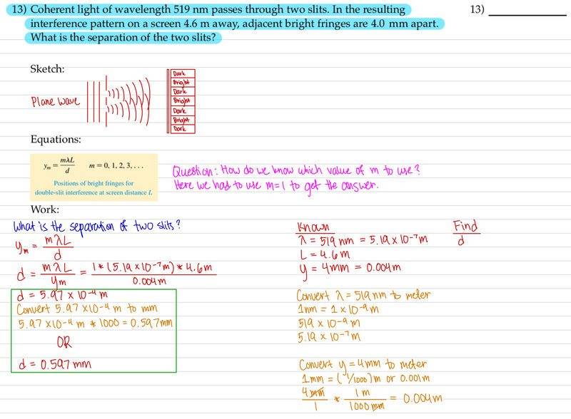

Finding the separation of two slits
asilvester635
How do I know what value of m to use when using the equation? Here we had to use m = 1 to find the answer.
Please refer to part 3 for the problem statement.
Please refer to part 3 for the relevant equations.

The formula gives you the location of the bright fringes. You are given the distance between consecutive friges, not the position of a particular one.
View attachment 223112 [/B]
"Adjacent bright fringes are 4 mm apart" means that the the distance between the m+1-th bright fringe and the m-th one is 4 mm.
## y_m =m \frac{λL}{d}## and
##y_{m+1} =(m+1) \frac{λL}{d}##
and ##y_{m+1}-y_m= 4 mm##
Subtract the firs equation from the second one, what do you get?
