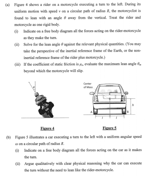

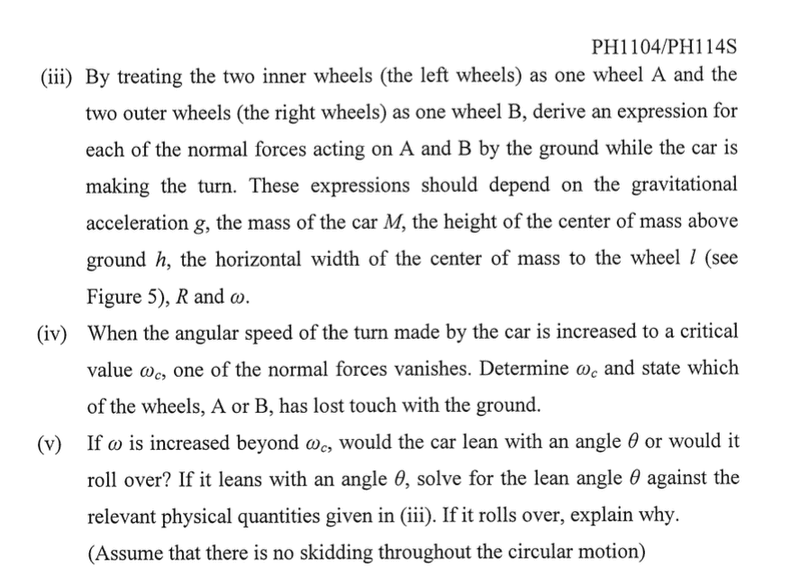

Apart from drawing a free-body diagram, I couldn't do much else. I can't seem to find the source of torque causing the car to rotate clockwise about its pivot (i defined it as the right tyre). I read from somewhere that we could take the centre of mass as a pivot as well but I'm not sure if that's right or how to go about analysing forces about that pivot.
You don't need to argue about torque exactly - you need to compare to the motorcycle case. Why does the motorcyclist need to lean?
When you drew up the free body diagram, did you assume the inertial frame of reference where the car is accelerating leftward? Or the rotating frame where it is stationary? I am guessing that you chose the former.
In that case, how does the leftward acceleration of the car affect its angular momentum?

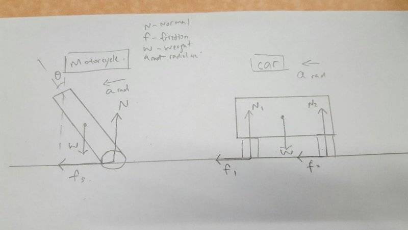

Here's the best I could come up with, though i have a feeling it's missing something.
Hand-drawn free-body diagram: a motorcycle leaning at angle θ with arrows for normal force N, weight W and friction f_s, and a car with normal forces N1 and N2, weight W and friction forces f1 and f2, both with centripetal acceleration arrows.
Both drawings feature a "a <- rad" notation. What does that denote? You have adopted the non-inertial frame in which the motorcycle is stationary. What is its acceleration in this frame?

It was supposed to be radial acceleration which was caused by friction, is this right?
In the non-inertial frame, the motorcycle and rider are stationary. They are not moving. They are not accelerating.
There is, however, a centrifugal force...

If the textbook said that, the textbook was wrong. The minute you decide to use the non-inertial frame, the centrifugal force becomes valid for use.
Edit: Let me expand a bit on that...
In the non-inertial frame, the driver plus motorcycle are stationary. Not moving. Not accelerating. Yet if we add up all of the real forces on them, there is a net leftward force. In order to preserve the usefulness of Newton's second law (f=ma) in this environment, the net force needs to be zero. The centrifugal force fills this requirement. In this case, it balances out the real forces so that the net is zero.
If you use a non-inertial frame and leave the centrifugal force out of your analysis then you will have objects moving around for no reason. Or unbalanced torques with no resulting rotation.
If you prefer not to use the centrifugal force that is fine. But then you should do your analysis in the inertial frame where the driver plus motorcycle are accelerating leftward. In this frame there is no centrifugal force. There is a net leftward force and a net leftward acceleration. There is also a net torque. But there is also a changing angular momentum if you look for it.
