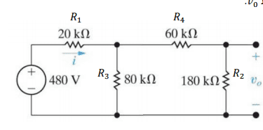

Find ##v_0##
looking for which way is the best
Using parallel and series resistor I have found that ##i=0.006 A## what should I do next?

What is the voltage drop across R1 ?

If you have i then you can find the potential drop across R1. Go from there.
Personally I'd probably have taken a different approach and transformed the source voltage and R1 into a Norton equivalent, absorbing R3 into it, then convert back to Thevenin and swallow up R4 too. That would leave a simple voltage divider at the end.
What I did is:
##180+60=240## than ##\frac{240*80}{240+80}=60## and than ##60+20=80k\Omega##

Yes, that's fine.
So I found that the voltage on ##R_1=120## so I have ##480-120=360## finding the current on ##R_{4+2}## is ##0.0015A## so the voltage on ##R_4## is ##90## and overall it is ##360-90=270##?
That works.

Correct!
