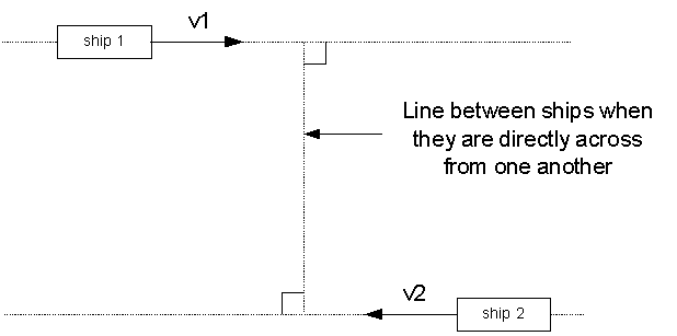

Two ships are traveling parallel to each other in opposite directions with seed v1 and v2. One ship fire on the other. At what angle should the gun be aimed at the target ship in order to make a hit if the shot is fired at the instant when both vessels are on the straight line perpendicular to their course? The shell velocity v0 is assumed constant.
The answer in text is : theta = arccos( (v1 +v2)/v0)
The book doesn't have an explanation, and I am having trouble just being able to draw the situation. I don't understand what it means when the problem says " when both vessels are on the strait line perpendicular to their course."
The ships are traveling along straight paths. The paths are separated by some distance, thus they are traveling on parallel courses. At some instant in time they will be directly opposite each other, so that a line perpendicular to their paths can be drawn between them.

Start by establishing your axes. For example, let the origin be located at one of the ships when it's path is perpendicular to the line of sight to the other ship, as given in the problem. Next, specify the x- and y-axes to be in the plane of the ocean, and the z-axis to be vertically pointed to the sky. Now specify the accelerations for each component and integrate from there.

Draw a diagram using the firing ship's frame of reference. The answer should jump out at you.

As I said, if you do everything in that boat's frame of reference the answer jumps out at you.
Ok so instead of finding two ways to represent the initial distance of boat two from boat 1(the origin) I used boat 1 as the fram of reference but I still ended up getting
theta = arcsin( (v1 + v2)/v0)
Here is my diagram : http://i44.tinypic.com/ndk0fa.jpg
The angle of bearing is usually measured from the bow, not the beam.
Thank you for telling me that. Now I understand the problem!
