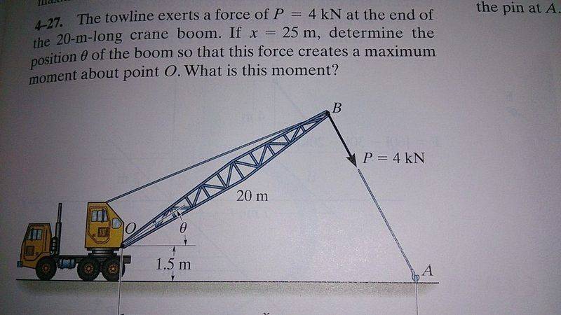

to achieve max moment , the 4 kN must br perpendiclar to 20m , right ? so, i formed a cloased triangle and use sine rule to find the
tetha , 25/ sin90 = 4/sin tetha , i gt my tetha = 9.2 degree , but the ans given is 33.6degree
i gt max moment = 80Nm

You've applied the law of sines incorrectly to this problem. You can't measure the length of one side of a triangle in units of Newtons, and another in units of meters.
And don't forget that the pivot point is shown as 1.5 m above the ground.
