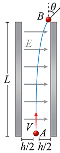

I need to find the tangent of the angle, but I don't think that is the part I'm messing up... Assume the particle doesn't hit the wall. Initial velocity is v. It seems that Vix = 0m/s and ay=0 m/s
Diagram of a charged particle entering a uniform electric field between two plates, with field arrows E pointing right, plate separation h/2 on each side, plate length L, particle launched upward at A with velocity V, and a curved path reaching the right plate at B with exit angle θ.
I thought vfx^2 =vix^2 +2a(xf-xi)
f=ma , f=eq
ax=a=f/m=eq/m
vfx2=vix2+2a(xf-xi)
vfx=(vix2 +2a(xf-xi))1/2
vfx=(2a*h/2)1/2
vfx=(eqh/m)1/2
Since vix=0, v=vfy
tanθ=(eqh/m)1/2/v

Tangent is a ratio. What is it a ratio of in this problem? Also remember the x and y motions are independent. Start by writing an expression for the time to travel the length of the tube in termas of v and L.

tanθ = Vfx/Vfy is what I showed above.
Time is not a variable that we can answer with, are you saying that I should use a kinematic equation involving time and then substitute another equation in for it?
The answer is in terms of e, q, h, m, v, L.

Yes, find an expression for the time to traverse the device in terms of the given values.
You were only told that the particle does not impact the plate ("wall"), so you don't know how close it comes to the plate before it exits (so you cannot assume that the particle moves distance h/2 in the x-direction).
Your final equation looks right to me, just use E rather than e.

The problem is similar to a horizontally launched projectile, so you can use all of its formulas, where your x is y in the projectile formulas :smile: or alternatively you can just rotate your axes 90o anticlockwise :wink:

I don't believe that the answer should contain h. See my post (#4) above.

I figured it out, thanks for the help, guys. In case anyone is wondering:
You must solve for t using a kinematic equation in the y direction, and then plug it into a horizontal kinematic equation to find Vfx.
It is worth noting that the horizontal displacement is NOT h/2, which is what was tricking me.
h is never needed.
I found this problem to be very misleading for this reason and due to it appearing that the horizontal displacement is h/2.
