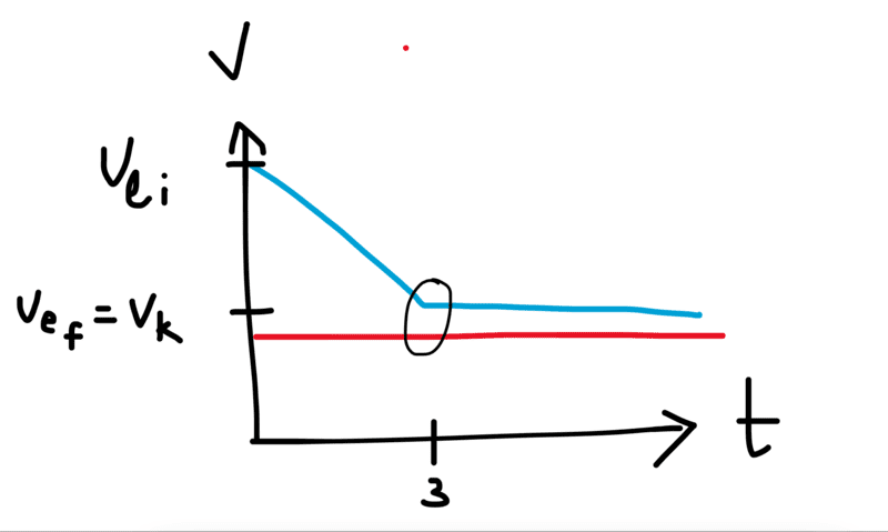

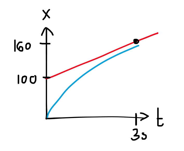

I drew a x(t) graph to try to map out what was going on. I guessed that in order to just barely avoid the crash, the velocity of Enterprise (v.e) will have to decrease to match the velocity of Klingon (v.k). So v.e final = v.k
Since we're looking for the acceleration, I used this formula:
vf^2 = vi^2 + 2a∆x
v.k^2 = v.e^2 + 2a∆x
for ∆x, I looked for the position of Klingon at t = 3 s.
xf = xi + vt
xf = 100 + 20(3)
xf = 160
∆x would then => 160 - 0 = 160 so
20^2 = 50^2 + 2a(160)
a = -6.6 km/s
which is obviously wrong :( the answer is supposed to be 4500 m/s^2
I feel like I'm missing a fundamental understanding of this problem. Will the Enterprise's speed not be equal to the speed of Klingon at t=3s? I'm super confused.
*I know someone asked about this question already, but I unfortunately still did not understand :( Thank u for your patience

How about also drawing a velocity vs. time graph.
On such a graph, what represents distance traveled?
vf^2 = vi^2 + 2a∆x
xf = xi + vt
xf = 100 + 20(3)
xf = 160
a = -6.6 km/s
∆x.k = v.k * ∆t = 20 * 3 = 60
∆x.e = (v.k + v.ei)(∆t) / 2 = (20+50)(3) / 2 = 105
I'm confused, is my graph wrong? Shouldn't the ∆x of Enterprise be equal to 160 if its initial position is 0 and it's about to catch up with Klingon?
That's not necessarily true that Δt = 3 sec.
What you do know is that Δx.e − Δx.k = 100 km . Right ?
So use your expressions for each of those but with Δt in place of the 3 in each. Then solve for Δt .
Once you have a value for Δt, then the graph can also give you the acceleration needed.
##3{1\over 3} ## s if you take the ##100## km/s seriously.
That assumption is where things start to go off the rails: the Klingon will have moved on from there by the time the Enterprise is at that point.
Do you understand that this is a two equation in two unknowns problem, with the two unknowns being time and acceleration ?
The limiting case is realized by an acceleration that achieves identical speeds when the distances between the ships is down to zero. Any more is overdoing it and any less means a collision.
So write down expressions for
##\Delta x = x_{\text{Enterprise}} - x_{\text{Klingon}}## in terms of knowns and unknown ##a## and ##t##.
##\Delta v = v_{\text{Enterprise}} - v_{\text{Klingon}}## in terms of knowns and unknown ##a## and ##t##.
then solve ##\Delta x = 0## and ##\Delta v = 0##

There is an approach that can do it without any algebra.
First, change to a reference frame in which the Klingon ship is at rest. Now you have a ship decellerating to a stop over a known distance with a constant but unknown acceleration. But you know its initial velocity and you know the distance. You want to find the decelleration. It would help if you knew the elapsed time (which would have been three seconds, were it not for the decelleration). So let us work on finding the elapsed time.
We could use a short-cut to get the elapsed time directly from the three second no-acceleration figure. But let us do it a slightly longer way...
Observe that average velocity is the mean of initial and final velocity (as long as the acceleration is uniform). You know both the initial and final velocities. You know that the acceleration is uniform. So you can easily calculate the average velocity.
Now you have motion over a known distance at a known average velocity. You can calculate the elapsed time.
Now you have a uniform acceleration from a known initial velocity to a known final velocity over a known elapsed time. So you can calculate the acceleration.

The problem can be solved readily by noting that under constant acceleration from 50 km/s to 20 km/s, the average speed is 35 km/s. I mentioned graphing v vs. t only because OP had already done x vs. t. -but then realized that the solution can be obtained from the v vs. t graph.
