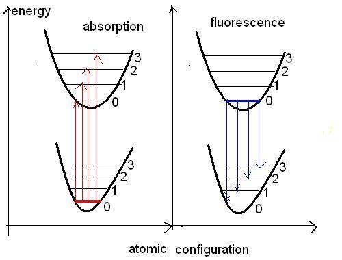

The fluorescence spectrum of anthracene vapor in the figure shows peaks with maxima at 440 nm, 410 nm, 390 nm, and 370 nm, whereas the absorption spectrum has peaks at 360 nm, 345 nm, 330 nm, and 305 nm. Assuming that only one vibrational mode contributes to these progressions, determine the vibrational spacings in the ground and excited electronic states.

2B is the spacing between the rotational levels. You need the vibrational energies, which are Ev=hf(v+0.5), with f the frequency of the vibrational mode.
The vibrational energies are superposed on the electronic energy. The possible electronic-vibrational energies of the molecule are E0+hf0(v+0.5) in the ground state and Ee+hfe(w+0.5) in the excited electronic state. When absorbing or emitting an ultraviolet or visible photon, the molecule undergoes a transition between the ground state and the excited state. The energy of the photon is equal to the difference between the energy of the states.
In an absorption measurement, the gas is cool, its molecules are in the ground electronic state and also in the ground vibrational state, and absorbing a photon, they go into the excited electronic state and to the vibrational state with w=0, 1, 2, 3, 4, ...
When recording a fluorescence spectrum, the molecule is in its excited electronic state and vibrational ground state, and emitting a photon, it undergoes onto the ground electronic level and and any of the vibrational levels with v=0, 1, 2, 3, ...
You can calculate the energy of the photons from their wavelength. These energies are equal to the energy differences of the levels.
