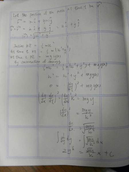

A bead, under the influence of gravity, slides along a frictionless wire whose height is given by the function y(x), Assume that at position 9x,y) = (0,0), the wire is horizontal and the bead passes this point with a given speed v to the right. What should the shape of the wire be(that is, what is y as a function of x) so that the horizontal speed remain v at all the times ? One solution is simply y = 0. Find the other.
I don't know how to solve this problem by using which physics equation?

Hi oscar_lai_hk! :smile:
Start with KE + PE = 0.

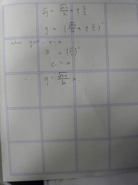

I try to solve this problem of conservation energy.but why the answer not include y = 0?
  • Handwritten derivation on lined paper: position vector r = x i + y j, speed v, energy conservation (1/2)mv0^2 = (1/2)m(vx^2+vy^2) + mgy(x), then dy/dx = sqrt(mgy/v0^2) and integrated to 2y^(1/2) = sqrt(mg)/v0 x + C.

  • Handwritten derivation on lined paper: sqrt(y) = (sqrt(mg)/v0) x + c/2, so y = ((sqrt(mg)/v0) x + c/2)^2; then with y = 0 at x = 0 gives c = 0, leaving y = (sqrt(mg)/v0) x.

Hi oscar_lai_hk!
Are those two jpg's your answer?
It will take hours before they're approved.
Please type your answer so that we can se it now. :smile:

The answer is :
y = (square root(mg) ) X /v
