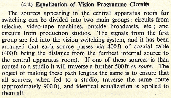

pbuk said:
I am not sure that is correct, do you have any source for that
OH ye of little faith. I have been in the basement of TC (years ago) when I worked there. (Good enough for you??? :-p) Here is some evidence for the basement under the fountain.
The architects made a virtue of necessity and put a visible statue at the centre to make it all look nice.
PS I will accept a bouquet as an apology for your ever doubting me.

Oh there is no doubt about the basement under the fountain (later replaced by the statue), and the video recording suite being located there.
However the Central Apparatus Room was on the second floor of the 'central wedge' of the doughnut: are you saying that cables from studios 3 and 4 (adjacent to the central wedge) were routed out into the centre under the fountain and then back in via the video recording suite and up to the CAR (presumably also with a feed from the CAR back to the recording suite)? Or was the editing and switching actually done in the tele-recording suite?
This drawing may help jog your memory (although I believe this is as designed not as built):

I have found a document that answers all these questions about Television Centre and more: http://www.tech-ops.co.uk/tech_guide.pdf (sorry about the hijack).
In summary:
  • There was indeed a central sync generator in the CAR which was fed to each studio.
  • Feeds from each studio went to the CAR where switching was performed and fed to the broadcast system.
  • There were separate feeds from each studio to the tele-recording suite under the central hub.
Also from http://tech-ops.co.uk/next/wp-content/uploads/2018/09/IEE-BBCTVC-and-Its-Technical-Facilities.pdf (what a mine of interesting stuff!)
In summary:
Excellent sleuthing, young man. So now we are up to date with the history of TC. Doing it 'that way round' makes a lot of sense . Everything was analogue in those days and long video delays were a lot of trouble so at least starting with good timing at each source was handy. I wonder how that layout design was arrived at (i.e. technical input). The result was a pretty iconic building which is identifiable from the air.
