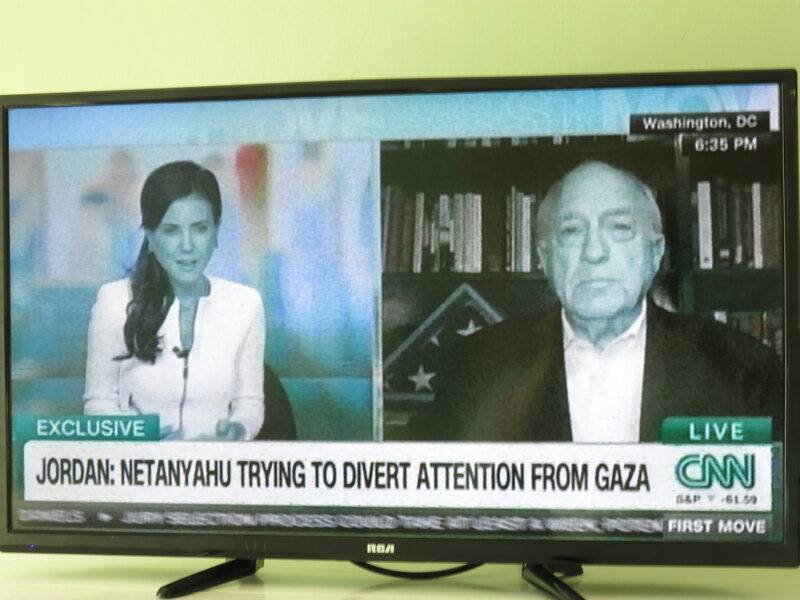

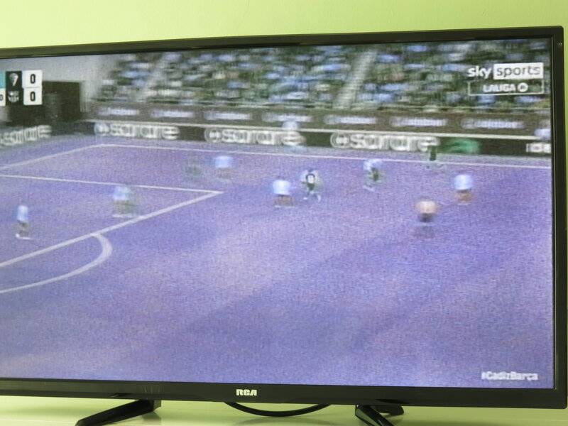

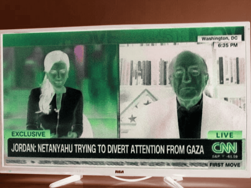

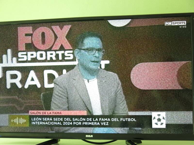

So this is the TV in our room in Cuba. It's an RCA - not ancient, since it's a flatscreen. It gets maybe two dozen channels, all of which look fine.
But a couple of times a day a half dozen contiguous channels would turn wonky-coloured. The effect would survive channel-changing, but would spontaneously correct itself after an hour or so.
Pink faces appear a cyan tint; solid red logos appear solid cyan:
Here's the correct CNN logo:
Blue logos appear red:
Green footie fields appear magenta:

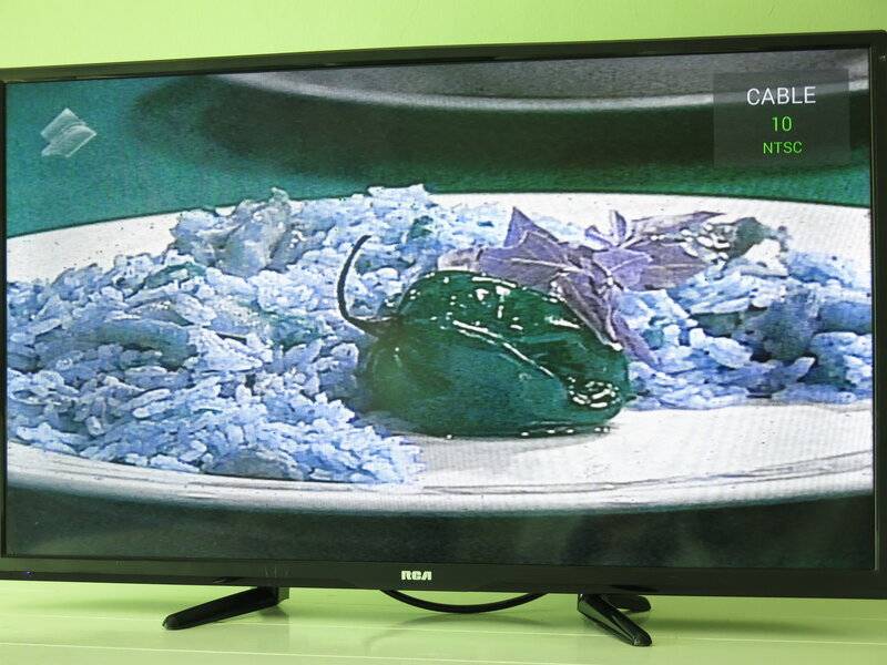

and dark red peppers appear dark blue-green:

Looks like you were watching NTSC, not digital. Maybe the TV in your room was tuned to an old local analogue transmitter by a previous tenant. Did you do a channel scan?

Sorry I didn't make this clear: what I'm really interested in is the technical aspect. This is a science observation; not a thing to be fixed.
I would not have been surprised if the entire signal was flipped, so that a white values are black and green hue is magenta. i.e. this makes sense to me:
But to have the black/white value be normal, while the colour spectrum gets flipped suggests they are somehow processed as separate signals and combined for display. I think.
i.e. this does not make sense:
The phosphors or LEDs or whatever are RGB, right? For the sake of argument, let's say they are analogous to a computer monitor: 256 increments of RGB.
So, dark red [255,0,0] has been converted to dark cyan [0,255,255].
For simplicity's sake, lets say skin is light magenta: [255,192,255]. It has been converted to light green: [192,255,192]. I would have thought light values would get flipped to dark values.
Can anyone suggest a simple, plausible way the algorithm that's converting RGB signals to screen colours could get corrupted (temporarily) to flip colour hues but not black/white values?

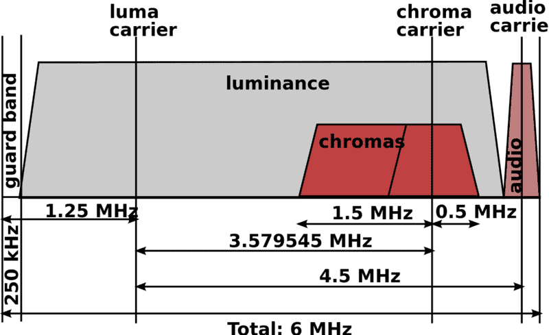

It looks like the significant point may be seen on this diagram:
As I suspected, the luminance data is distinct from the chroma data.

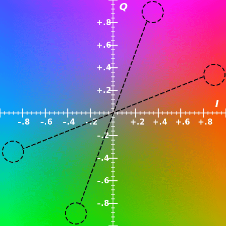

With NTSC (Never The Same Color), the I and Q signals are color differences:
In phase = I = red-cyan. Quadrature phase = Q = magenta-green.
https://en.wikipedia.org/wiki/YIQ
Phase lock failure of the color sub-carrier (on 3.58 MHz) results in a rotation of the YIQ color space being displayed.

Post #1, 6th image, identifies as "Cable 10 NTSC".
It seems there is an archaic cable TV system that distributes within the premises.
Is there any evidence that other TVs have the same problem?
Is the problem with the digital to NTSC conversion for the cable system?
Or is the problem only with this one TV set?

@DaveC426913 's diagram
Shows the transmitted spectrum. NTSC (or even moreso , the later PAL coding) was incredibly inspired. A narrow band compatible mono signal was available for reception by old B/W TVs. That signal is Vestigial Sideband AM. Double Sideband AM carries Video frequencies up to 1.25MHz and higher video frequencies up to ab out 4MHz. The HF components still get detected by a simple envelope detector. The carrier presence still allows the simple 'crystal set' detector to work (like a SSB recfeiver) with just a bit of equalisation. to give almost 4MHz of mono (Y signal) video bandwidth (brilliant!) The Colour Subcarrier is set to be be a strange multiple of TV line rate (cant remember the number) so that all the comb of spectral frequencies of the chrominance signal sit right in between the comb of the mono spectrum. So, for a stationary part of the poicture, they interleave and can be demodulated independently. (clever or what?). There is a burst of pure colour subcarrier at the start of each line to sync the chrominance demodulator. Plenty of opportunity to get a phase flip.
There was another smart thing. 'Intercarrier Sound'!) The sound carrier was demodulated by an SSB detector, using the vision carrier to which it had been locked.
The Chrominance 'subcarrier' uses two phase quadrature components with two 'colour difference' signals. Phase slope across the transmission band is a problem for basic NTSC but PAL reduces this by alternating the subcarrier phase to cancel out any overall tilt.

I gave the format in post #12.
It is not being flipped in RGB format, it is being rotated in the NTSC IQ sub-carrier space, which requires reliable phase locking to the short colour burst reference transmitted on the porch of each line.

That link includes all the transformational matrices. Rotate the colour picture to see what colour might move where, when the IQ phase reference gets confused.
This is what I had been wondering. (Even though I didn't know the actual details) I was trying to see if it was flipped (i.e. Rd to Cy, Gr to Mg, Bl to Ye) or rotated (Re to Ye or Gr, Gr to Cy or Bl, Bl to Mg or Re) since a rotation seemed more logical. I concluded it was a flip. I still think so. I was pretty careful to note that
Red was showing up disinctly Cyan
Cyan was showing up disinxtly Red
Green was shoeing up distinctly Magenta.
I guess a rotation of 180 degrees on that table is the same as a flip (or is it??).
I think I am struggling with a rotation in a 2D color space (Mg-Gr, Re-Cy) versus a mirrring in a 3D volume (Re-Cy, Gr-Mg, Bl-Ye) space.
Also, I was unable to find any unequivocal blue/yellow flip.

It depends. Since the I and Q channels encode colour differences, locking with a 180° phase shift will invert both differences.
Diagnosis of the fault in the PLL or matrix computation by colour alone is possible, but not without a test pattern when the TV is in another country.

Point 1 and 2 I think strongly suggest the cause is independent of the TV itself.
Sounds logical.
NTSC is very fussy about phase and filters are much easier to tweak for amplitude.
Now, why some channels but not others? (Not just one channel?) Assume the broadcast transmitter / cable head takes digital feeds and has a bank of ntsc coders. Each ntsc signal (at an IF frequency) will be mixed up to a suitable RF channel and combined with the others. From the fact that it’s only in one group it’s probably happening in one particular frequency multiplexer.
If DTV has been available for ten years or more can we conclude that nothing has bee spent on this analog system for years and they’re waiting for a full upgrade to DTV? It’s just quietly dying . RIP
The problem I see with NTSC is multi-path propagation, where the colour burst is phase shifted by the addition of a delayed reflection.
That could also happen with reflections in a mismatched or faulty cable network.
