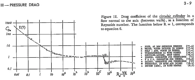

No rule of thumb, but here is how I would approach the problem of calculating pressure loss.
1) Thermocouples are normally in a thermowell. That well has a diameter and length. Calculate the Reynolds number from the thermowell diameter and fluid velocity.
2) Find the drag coefficient, ##C_D##, from a chart such as this one in Fluid Dynamic Drag, by Hoerner.
3) Calculate the drag force from ##C_D## and fluid velocity.
4) Pressure loss is the drag force divided by the flow area.
Use engineering judgement to determine if the pressure loss is acceptable.
