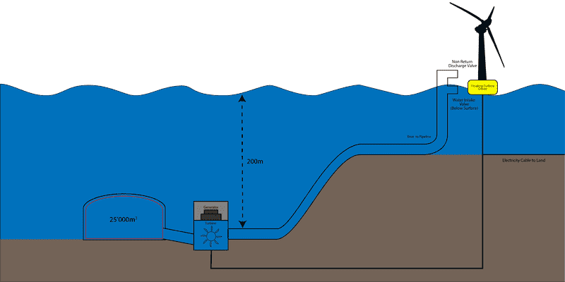

I've designed a subsea pumped storage hydro system and want to know if I'm on the right track with my flow rate and head loss calculations
I've created a concept design of a subsea pumped hydro storage system, and need to use the flow rate in order to calculate power output. I can calculate the energy storage capacity using ##E = mgh##:
$$E = mgh = 25675000×9.81×200 = 50374 MJ = \frac {50374MJ}{3600} = 13992 kWh$$
I've attempted to determine the flow rate by choosing a turbine (5MW Francis from https://www.researchgate.net/publication/302969536_The_use_of_LINGO_programming_language_to_develop_a_computer_tool_to_provide_a_technical_and_economic_analysis_of_a_hydraulic_potential_that_allows_the_application_of_Francis_turbines_and_Kaplan_turbin/figures?lo=1) and working backwards, to then find the resulting pipe diameter and head loss. In the model below, the top of the pipe has a valve that will open to let seawater in during the power generation stage (high energy demand), down through a 90/10 Cu/Ni pipe, through a turbine and subsequently fill up the vessel, which is located 200 m below the inlet (Head = 200 m). Vessel design doesn't take into account the pressure at this depth through use of a bag seen here. In times of low demand, using excess energy produced from the wind turbine, the water will be pumped back up to the surface to be stored as potential energy.

  • Cross-section diagram of a subsea pumped hydro storage concept: a 25,000 m3 storage bag on the seabed, a pump-turbine unit, a 200 m vertical head, a pipe rising to a surface turbine, and an electricity cable to land.

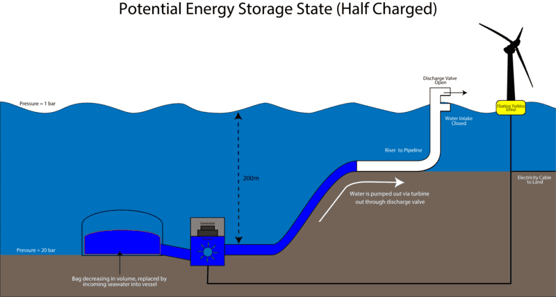

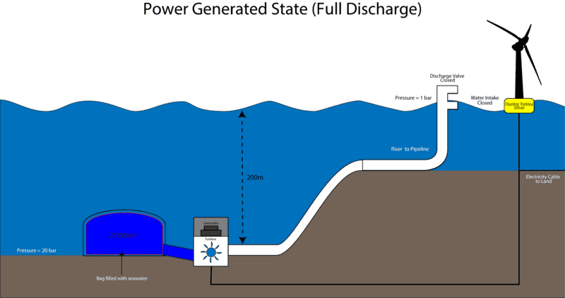

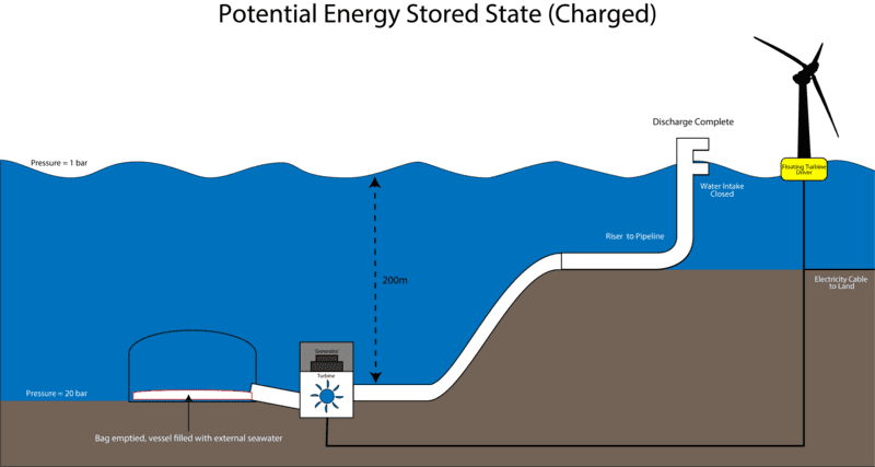

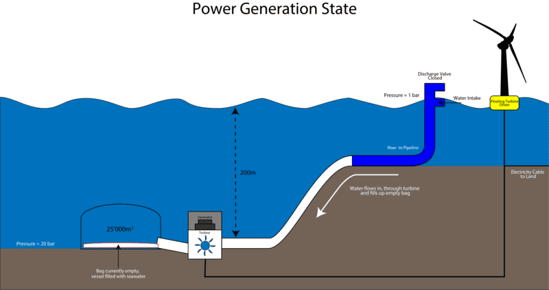

A bag is employed to isolate oil from water, the pressure inside the bag is the same as outside the bag. If there is no pressure difference between the bag and the external seawater in contact then there is no energy storage benefit from the bag. The storage volume then becomes that of the tube that may be filled with air or water.
Consider the pipline and an air pump/turbine. You could pump air into the bag reservoir, raising the world wide sea level very slightly during the process. Then you could release the compressed air to recover the energy. The system would operate at approximately 20 bar pressure difference. The pump/turbine could be at the surface.
But I can't see how you could do it by pumping water through the pipeline since the hydrostatic pressure will then be the same in the pipeline and the ocean, so there is no pressure difference.

Maybe you need to draw four diagrams of your system. Discharged, half charged, fully charged, and then half discharged. Mark on it the presence of air or water. Start at sea level and mark the hydrostatic pressure, inside and outside the system. Look for where there is a pressure difference across the wall, between the inside and the outside. When is there any pressure across the turbine?

I created these, I see what you mean about the pressure, since the vessel is always water it'll be in equilibrium; if I was to disregard the bag altogether and create say, a concrete vessel of similar size would it then work? I guess it'd be very similar to the StEnSea project but worth asking.
