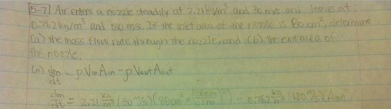

Here is the question along with my attempt:
Handwritten solution to problem 5-7 on lined paper: air enters a nozzle at 2.21 kg/m^3 and 30 m/s, leaves at 0.762 kg/m^3 and 180 m/s, inlet area 80 cm^2; then mass flow rate setup with dm/dt = rho Vin Ain - rho Vout Aout.
As you see in my second equation there are two unknowns, A_out and dm/dt.
I think my problem is that I don't exactly understand the equation. dm/dt is the net mass flow rate. For example if dm/dt is a positive number then there is more flowing into the nozzle than there is flowing out. In other words there is a build up of mass in the nozzle? I guess this isn't possible since we have a nozzle and that is why in this case dm/dt = 0? Because that is the only other way I can think of doing this problem but I am not too sure.
In what case could dm/dt be positive? I am guessing when there is a tank that can be filled... But how do I know that the nozzle doesn't have a small pouch where the mass can build on itself...?
Also when they say "mass flow rate through the nozzle" is this dm/dt or is it the mass flow INTO the inlet nozzle?
Thanks!
Edit: for those who read through my solution attempt, there is a mistake in the last line where I did my conversion from 80cm^2 to 80m^2. the 100cm/1m needs to be flipped.
The equation of continuity states that the flow rate past one cross section of a pipe needs to be the same as that through another cross section
J = A1v1 = A2v2
This gives you the volume flow rate. If multiplied by the density of the liquid one would get the mass flow rate passing through a cross section of the pipe.
