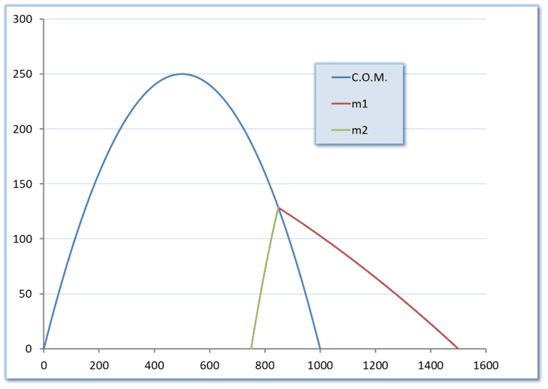

For whatever it's worth, here is a plot of one of the many solutions. The projection angle looks greater than 45° because the axes are not equalized.
Input parameters
Initial velocity components: ##v_{0x}=v_{0y}=10~##m/s
Horizontal position of explosion: ##\Delta x = 6~##m
Velocity change of smaller mass: ##\Delta v_1 = +7~##m/s
Velocity change of larger mass: ##\Delta v_2 = -3.5~##m/s
##g=10~##m/s2
BvU said:
Preliminary guess: no.
Correct. To generate the plot I picked a horizontal distance of 6 m for the explosion and then figured out the initial velocity of the smaller mass needed to reach ##\frac{3}{2}R## from the launch point. The larger mass was given half that velocity as required by momentum conservation. How much velocity is needed can be translated into how much energy is released during the explosion.
Note that if the explosion occurs when the projectile is directly above the ##\frac{3}{2}R## point, it must deliver an impulse that exactly cancels the horizontal velocity of the larger piece which will then drop straight down while the smaller piece reaches its expected destination. The explosion cannot occur past that point because the larger piece will have to be kicked backwards which means that the smaller piece will land past its expected landing point. In other words, there are limits to where the explosion can occur while fulfilling the statement of the problem.

kuruman said:
The explosion cannot occur past that point because the larger piece will have to be kicked backwards which means that the smaller piece will land past its expected landing point. In other words, there are a limits to where the explosion can occur while fulfilling the statement of the problem.
Respectfully beg to differ ! I see no objection against m2 being kicked backwards...
Of course! I did it in my head and it didn't register that the projection angle after the explosion is below the horizontal.
